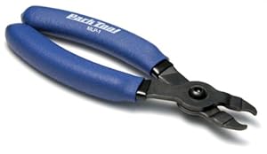

SRAM links come apart easily with a pair of these (or similar).. haven't had any issues with reusing them either..

Powerlocks are fine as above you just need the tool.
Even KMC links are stiff enough to warrant the tool, i've got them off without but it's a pain.

the special pliers always help though.

+1 KMC 10 speed, although I do admit to having bought one of the tools for home use 🙂
This.

OK, Park thingy ordered, thanks
Posted : 30/05/2014 4:29 pm
Posts: 8
Park thingy works a treat 🙂

Superstar have reasonably priced link pliers.
