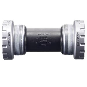

Lastly, is the XT bottom bracket a good piece of kit, or seeing as I'm building this from scratch, is it worh investing in something like a Chris King BB from the off?

fit the XT BB when the bearings are shot (be a while yet.) send it off to betd and get enduro bearings put in it.

XT BB - I definitely wouldn't bother as you'll get plenty of time out of the XT and its paid for.

XT bottom bracket it is then... cheers guys. Is it likely that the axel will need maching to length? If so, this might be the one job for the bike shop I guess.

The BB is hard to get wrong, either it screws in flush or it doesn't. If it doesn't you probably need the threads chased. You need spacers for your cranks.

all about BB fitting;
[url= http://www.parktool.com/blog/repair-help/external-bearing-crank-systems-hollow-tech-ii-megaexo-gigaxpipe-x-type-ultra-torque-bbt ]http://www.parktool.com/blog/repair-help/external-bearing-crank-systems-hollow-tech-ii-megaexo-gigaxpipe-x-type-ultra-torque-bbt[/url]

Are the shell faces likely to need machining, or does the frame come from ragley already prepared?
This is what I meant in my post above, but got my terminology mixed up and called it the 'axle'!!
Posted : 18/10/2010 1:58 pm
Nope they are standard to go between the BB and the frame, can't remember the set-up on the Blue Pig but you should have spacers in with your groupset and all you need is the BB size of the frame and then you can follow the Shimano instructions to give you the spacers required for that BB size.

Aha, the park link had a good sketch on there. 68mm shell on the pig, so looks like 2 x 2.5mm spacers on the drive side and 1 on the non-drive.
This bit more true IMO, but not impossible. Some BB cups (external ones) are a much tighter fit than others, to the point where you'll struggle to get more than one or two turns in by hand before you have to resort to using a BB spanner. With only one or two turns in, it's possible to still have the threads crossed; if you then use a BB spanner to force the cups in, you could strip the threads on the BB shell.

the threads for the Bottom-bracket:
have funny threads, the drive-side is a left-hand thread, the non-drive-side is a right hand thread.
(left hand thread = anti-clockwise to go in)
(right hand thread = clockwise to go in)
i din't know if you knew that or not, they should go in by hand until the last 1/8th turn. if it feels tight going in, you should get the thread 'chased' by your local best bike shop.

Yep, understood on the BB threads. I'll wind them into the frame by hand and see how smoothly they go, to see if t needs the threads chasing.
This leads me to anoother question though..... even if they screw in nice and smoothly by hand, is there a chance that the faces on the frame might not be complately parallel (excess paint etc) and that they could become slightly miss-aligned with the last 'nip' using the BB spanner? Even on a brand new frame?

rich_959 - Member
yes, it can happen.
if may or may not be down to excess paint, the face of the frame might be not be square to the thread.
many people don't believe it, but it can happen, and a wonky face will shorten the life of the bearings.
your frame is probably fine, but the only way to know for sure is ask your best local bike shop to 'face' the B-B.
(screw the bearing in, when it's close to the frame, have a look to see if it's obviously not wonky, use some feeler gauges if you've got them to see if there are any spots closer than others)

Screwed the BB in last night, and after a small amount of resistance (I assume from the bit of oversprayed paint in the threads) it went in smoothly, almost all the way up to the frame - gap seems the same all the way around with feeler gauges (cheers ahwiles). I reckon I'll nip it up and see how I get on.
