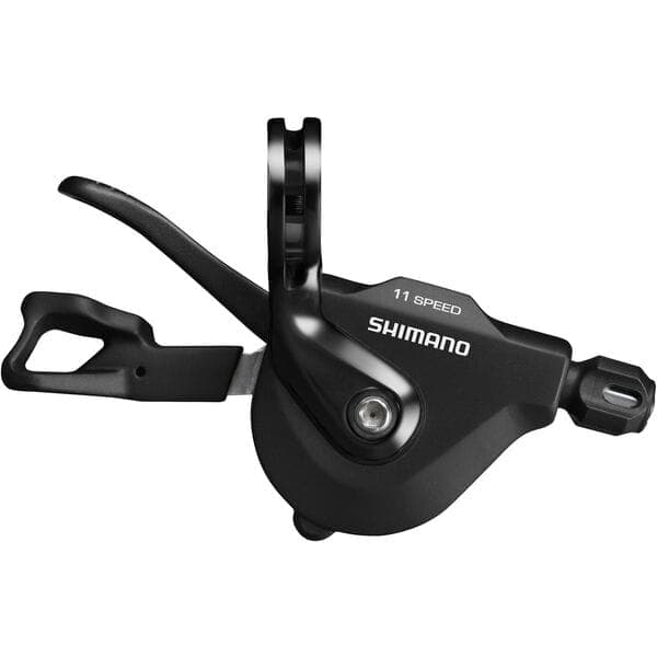

Depending on what your rear mech is you might be able to use flat bar road shifters instead of having to replace the mech, these are what I have with a GRX 11 speed mech: https://www.bikeparts.co.uk/products/shimano-ultegra-sl-rs700-band-on-flat-bar-shift-lever-11-speed-right-hand-black?currency=GBP&variant=42273351368861&utm_source=google&utm_medium=cpc&utm_campaign=Google%20Shopping&stkn=a894e8283159&gad_source=1&gad_campaignid=17176658334&gbraid=0AAAAAC6PGhx8DlAyhEhTqQvvLLHutP-h1&gclid=Cj0KCQjw9O_BBhCUARIsAHQMjS7nqKsIfvsNqYoSExFRVbqVL-nYwgRa8tGSoBLi9iTLwr8VxnXtKnkaAkjUEALw_wcB

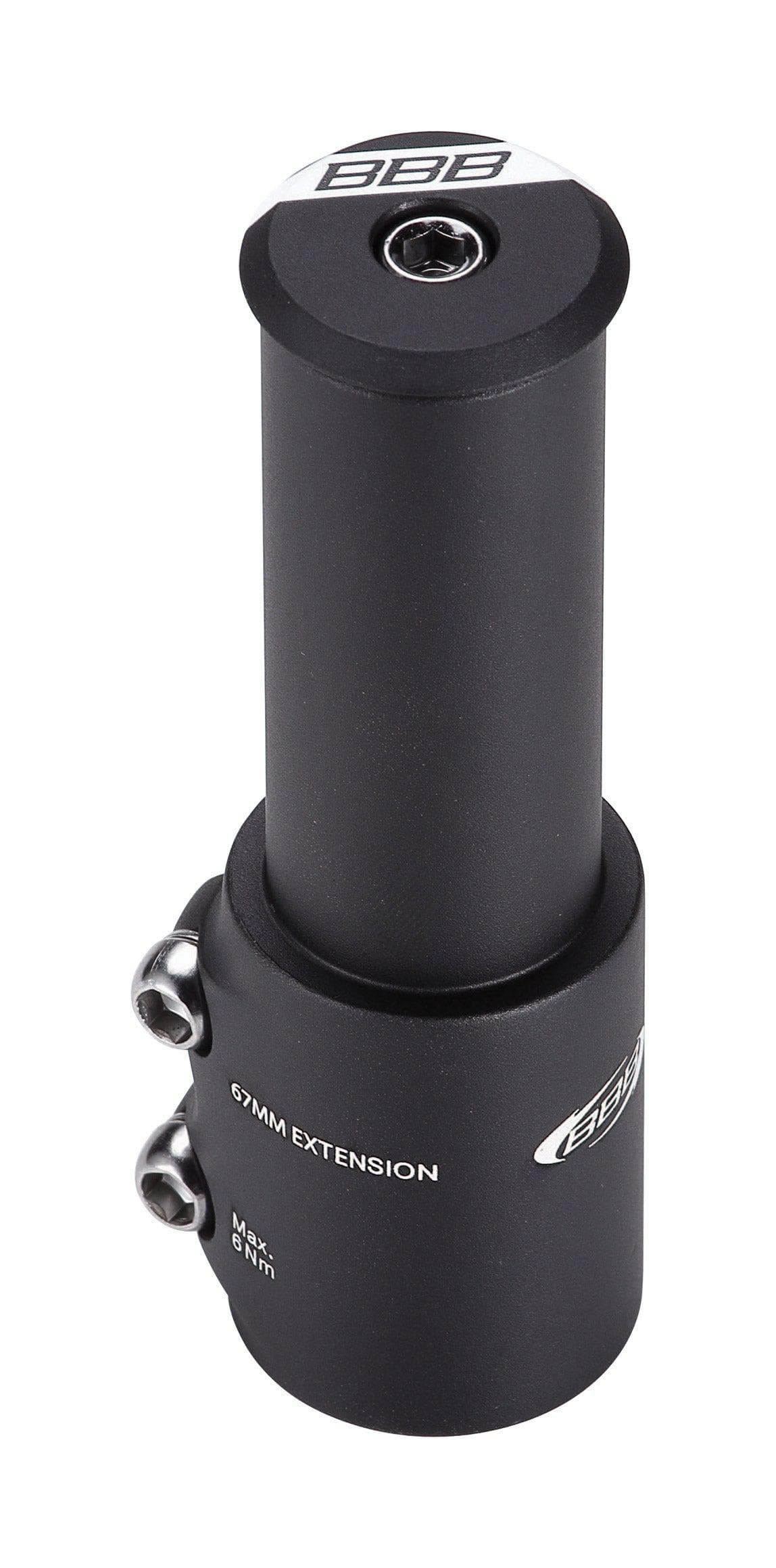

A Quick Look at the geometry, in my size, the Substance, is very low on stack, 3cm less than my Arkose. Plus my Arkose now has a steel fork so I’m using lots of spacers. I’m pretty inflexible due to past neck and back issues. With my crazy high bars I’ve been comfortable for a 12 our day.
 Personally I’d try one of these to raise the bars before doing anything else. Cheap to try and will give loads of adjustment.
https://www.bikeparts.co.uk/products/bbb-bhp-22-tubeextend-steerer-extender-28-6mm-black?currency=GBP&variant=43186498044061&utm_source=google&utm_medium=cpc&utm_campaign=Google%20Shopping&stkn=a894e8283159&gad_source=1&gad_campaignid=17176658334&gclid=Cj0KCQjw9O_BBhCUARIsAHQMjS7D9ovwVfOILRjo3Ih_Xk8rCkrwD5n5IlDiKh1ddAPTLpoO6oir5SMaAvybEALw_wcB
