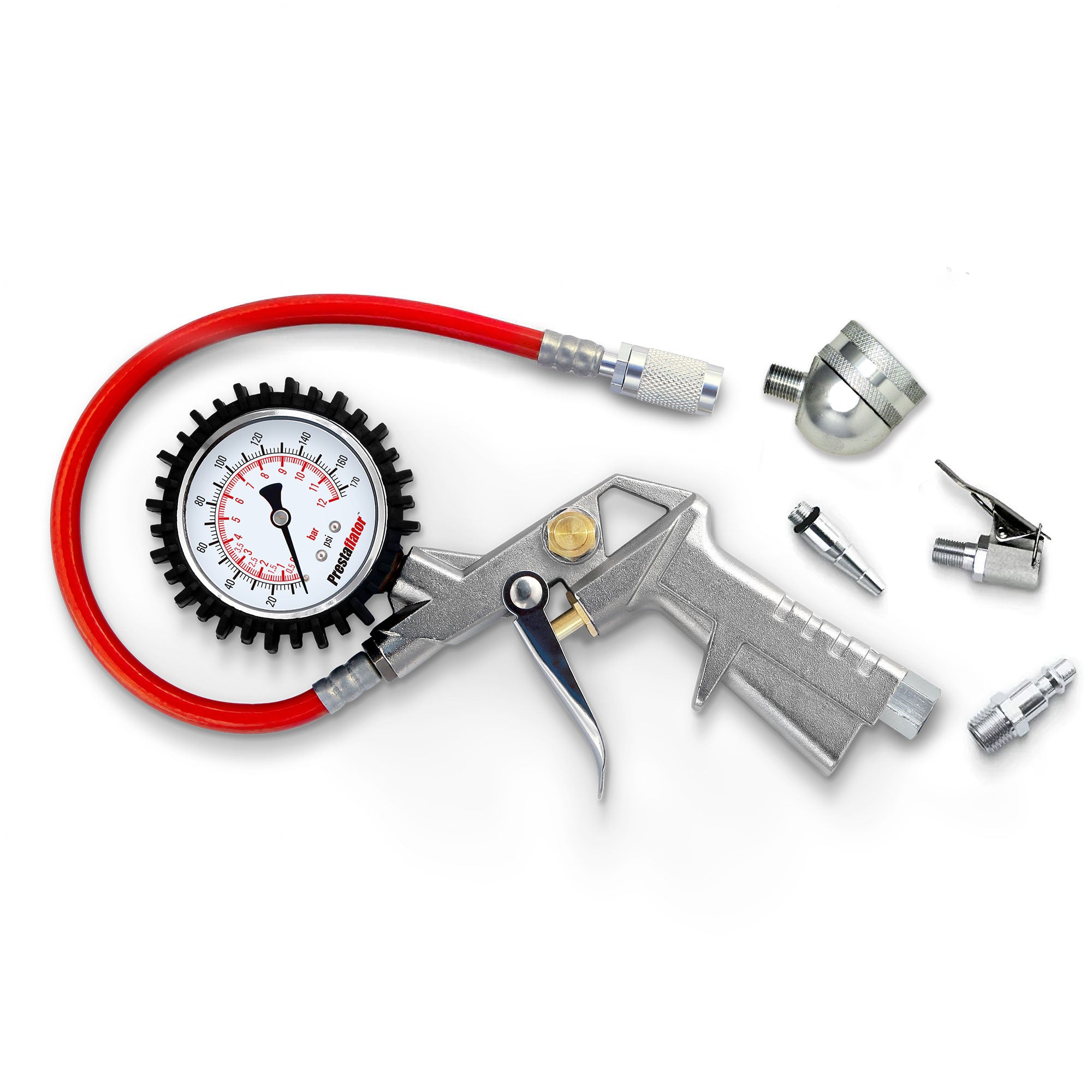

Yes I saw that but it gets mixed reviews on Amazon...
Prestacycle
There is also the Jaco one which gets better reviews but requires an additional £50 attachment..
Jaco
Just wondered if anyone had experience of any and wanted to recommend..

I’ve been using a cheapo blue trigger one with a Joe Blow hose grafted on. It works, but it leaks and I’ve had to replace the hose several times now. I decided I was going to treat myself to a ‘proper’ one so watching this thread with interest.
I once bought a Prestaflator and was underwhelmed with how it felt so sent it back. Didn’t actually use it though.
@bikerevivesheffield can you post a link? Can’t work out what you mean. Edit: oh I see what you mean. Not what I need unfortunately.

Posts: 1352
Simple and works. Lack of a gauge is slightly annoying but for getting tubeless seated/inflated it just does the job and is a sensible price.
https://www.gonebikingmad.co.uk/collections/inflation-tools/products/prestaflator-mini-bicycle-tire-inflator-presta
