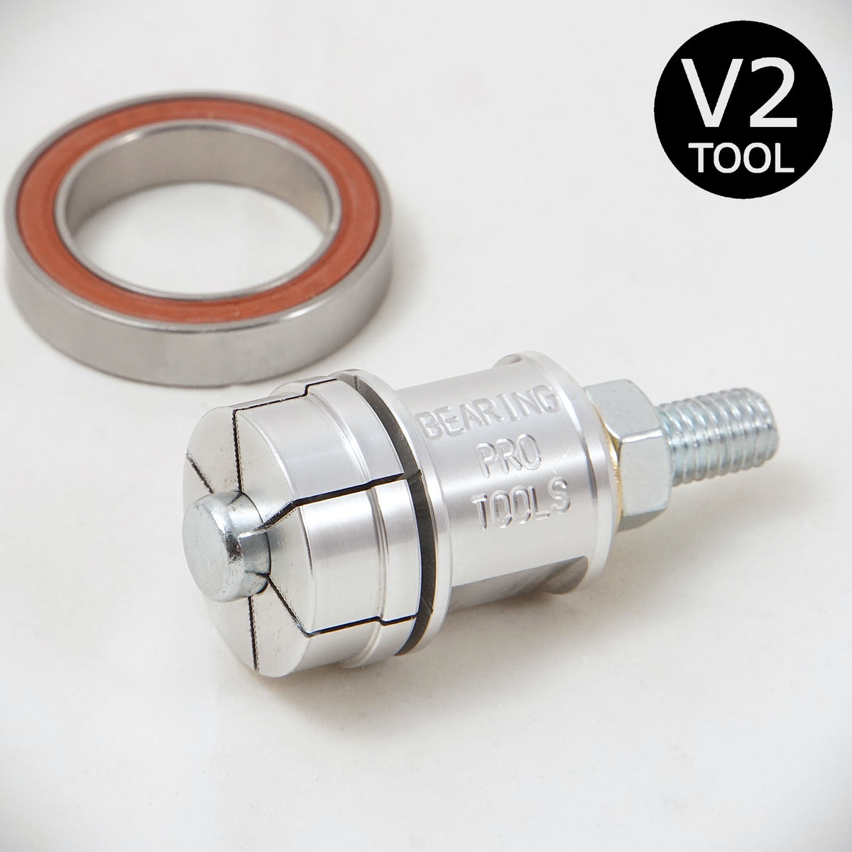

https://www.bearingprotools.com/collections/bearing-presses-for-bottom-brackets/products/bottom-bracket-bearing-puller-expanding-type
I've got some of their hub bearing presses so just ordered a bottom bracket extractor from the above. Not much more than the cheap type you're looking at.

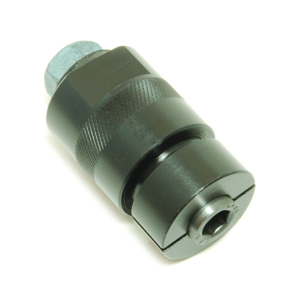

Posts: 2776
These do the job nicely
https://wheelsmfg.com/presses-tools/bottom-bracket-tools/6806-30mm-sealed-bearing-extractor.html
Other sizes available.
Probably only worth getting this style over a cheaper rocket type one if you want to keep the cups and replace the bearings only. But I found the cups would normally come out with the bearings.
