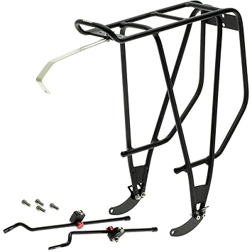

That particular rack looks like it could cause some issues with a seatstay mounted brake. There are racks available with wider stays, and standoffs for attaching to the frame.
http://www.wiggle.co.uk/topeak-super-tourist-dx-fdisc-rear-rack/
[img] ?w=1200&h=1200&a=7[/img]
Posted : 03/11/2016 1:43 pm

Axiom rack should come with those too - at least my Axiom Fatliner did. They're the black rods in the bottom of the pic in Mowgli's post.
