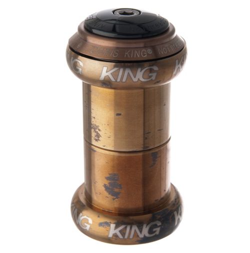

How deep are your cups, CK steelset? How deep are your cups?
[img] http://media.chainreactioncycles.com/is/image/ChainReactionCycles/prod2035_Steel%20Brown_NE_01?wid=500&hei=505 [/img]
Though, as above, machined part of ally steerer tube may not be deep enough to accommodate.
