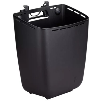

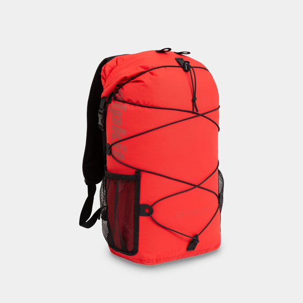

Posts: 13594
Because my commute is sometimes driving and sometimes riding, I’ve decided best setup is a single small rucksack with all work gubbins in and then, when riding, I’ll drop it into a simple pannier. Pannier will stay attached to bike, when I get to work I’ll just lift work bag out and job is jobbed. So, my set up needs to be:
I have this:
Specialized Coolcave Pannier box £30: https://www.sigmasports.com/item/Specialized/Coolcave-Pannier/10E04
Alpkit waterproof rucksack £33: https://alpkit.com/products/gourdon-25-dry-bag-backpack

I quite like that Specialized coolbox thing.
