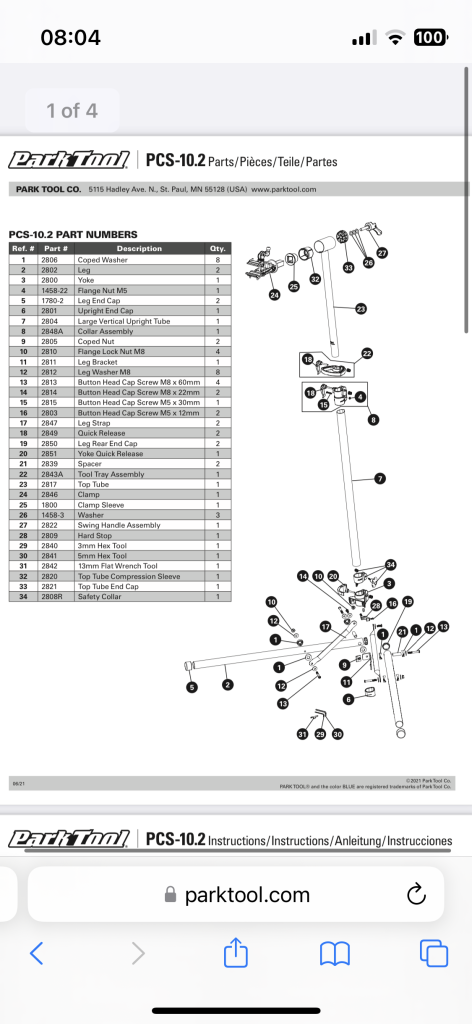

So I have a park tool 10.2 workstand. It wasn’t the cheapest but also wasn’t the most expensive thing out when I bought it.
It is sturdy although it would have been nice if the main upright would turn rather than being u shaped.
I’ve somehow mangled the lower qr that holds the main upright vertical - I think because it always needed to be VFT to stop the stand collapsing forward with heavy bikes in it.
I’ve found the part number but can’t find it for sale in the uk at all - tried Amazon / eBay and several bike shops. SJS looked into it for me and said the uk distro no longer holds / supplies the part 🤦‍♂️
Nothing else wrong with the stand at all so I’d like to fix it - anyone else had this issue? I guess a straight forward bolt would do the job - preferably with a twist knob on the ends of it. A normal bike qr is probably way too long and I’m not sure a seat post clamp would do it.
It’s either that or I maybe able to get the part from Park US but it’s $17 and then a minimum of $20 postage plus any vat or import duty. A lot for a simple qr really.
Any ideas?

Howxabout a bit of threaded rod and some nuts. It becomes a slow release but still functional
I also found qr levers that would fit threaded rod but no idea where I got them from
Posted : 08/09/2023 7:53 pm
Posts: 10337
@jamiemcf - not ideal but that’s my backup plan. Can’t quite believe they’ve discontinued the part. Wonder what the 10.3 new version uses 🤔

Posts: 4459
What was the code/part number?
Posted : 09/09/2023 12:07 am
Posts: 10337
@hatter - it’s 2851. In the below diagram it’s number 20.

 Del
Posts: 8296
Is it easy to cut a thread into a rod like a qr? I’ve got a tap sets for internal threads to a hole but not a set for the other way round.
Yeah. If you've got a thread to start with but just need to cut it further along the length it's easy because the existing thread will get you straight. There are usually three screws that hold a die in it's holder. Use the centre one alone to start, cut down to your desired finish point, them back out and undo the center one, tighten the outer two, and go back down. Slow and steady wins the race, just take nibbles out, 1/4 or 1/8 turn and back off to clear swarf. Use oil and a stiff brush to help clear the crap out.
Hopefully park will see you right though. 🙂
Posted : 09/09/2023 7:58 pm
Posts: 10337
Update - Park have come through for me - fair play.
They’re going to send me a new qr and also a revised ‘safety collar’ that later versions of the stand had to stop them collapsing forward / relying just on the qr.
Assuming the bits arrive that’s amazing customer service and I will continue to buy Park tools stuff on that basis.
Posted : 13/09/2023 12:00 pm
