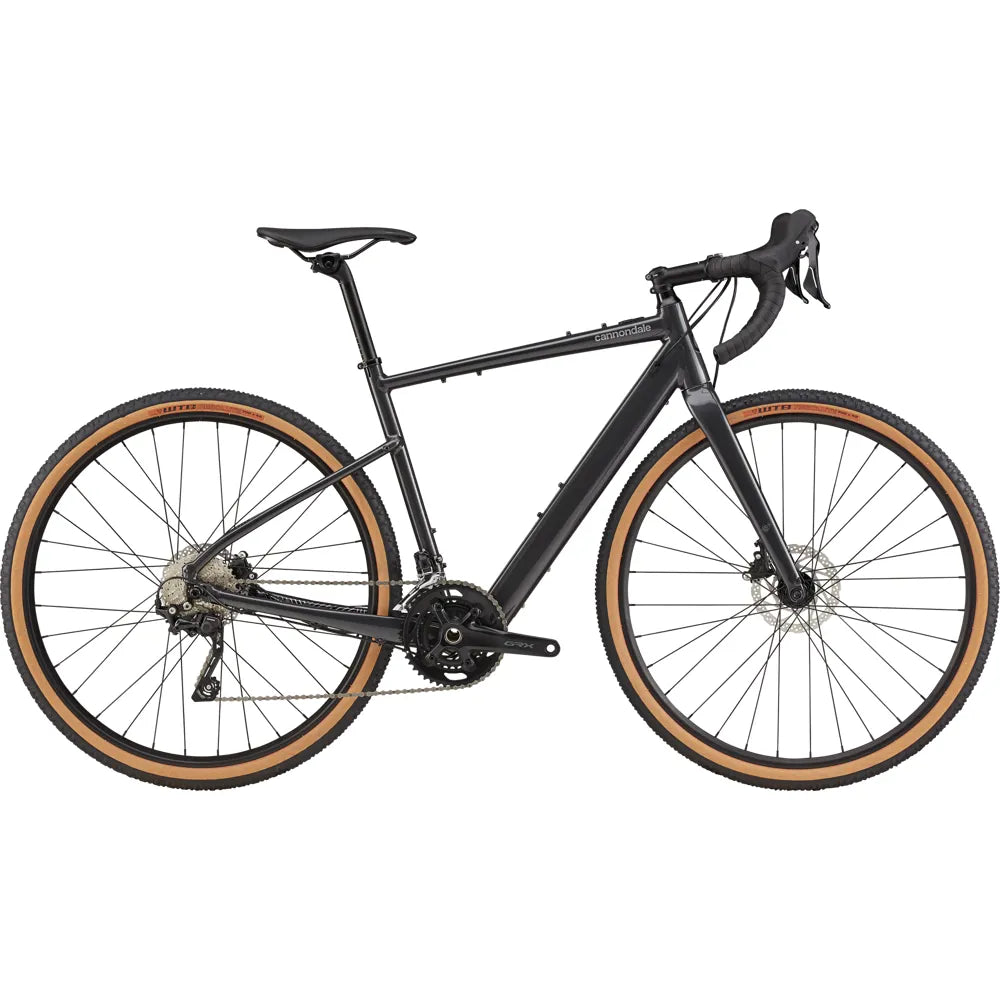

sorry for a bit of a thread hi-jack, but i have a cannondale topstone gravel bike, purchased a couple of years ago. Its this model:
https://www.hargrovescycles.co.uk/bikes/road-bikes/2020-cannondale-topstone-105-mens-gravel-bike-in-grey__31270
It has bosses for what i assume is mud guards or pannier racks.
Having never purchased or fitted panniers before, are they fairly universal and will/should fit with the available bosses on my Topstone? As i want to use the bike to commute with in the near future, it would be nice use a pannier rather than have a bag on my back.

That Cannondale up there ^^^ should fit a rack no probs. We have 2 or 3 Tortec ones on bikes here. The ultralight one on my old audax style bike that I use for commuting is great but if using bigger panniers then it's preferable to have a larger side frame rather a simple V shape to prevent the bottom of a large pannier flapping into the wheel when you've been to Tesco and packed awkwardly or are carrying them empty on a windy day. The Tortec tour rack that is on my wife's bike reduces this issue.
