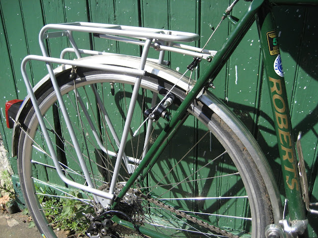

These are great prices for Tubus. I got a Logo and Tara from them. You can get a mounting kit that fits on the skewer.

Just to clarify mcmoonter have you fitted the logo to a 29er?

I fitted the Logo to a 700c touring bike with mudguards. I believe there are two sizes. 26 ich & 700c (29er)

The top of the Tubus Logo sits a good way above the mudguard. The panniers mount semi low rider stylee.

There is a fair bit of clearance above the tyre and 'guard for a 29er tyre.
