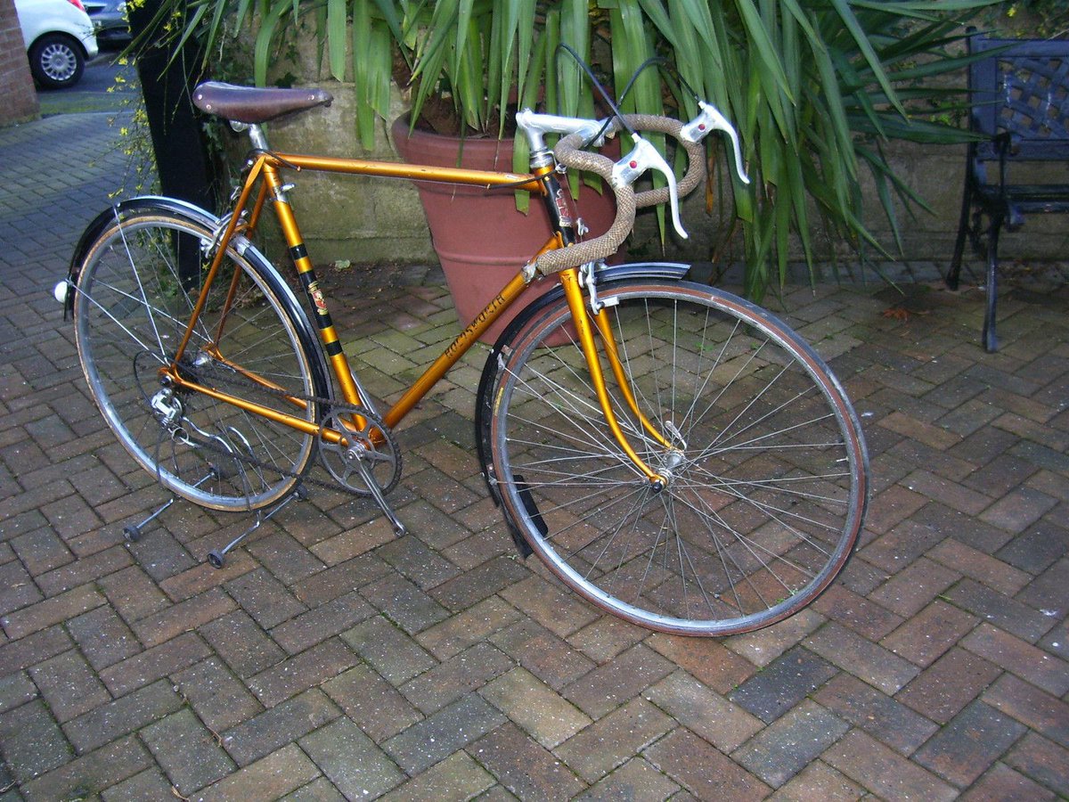

Seems to have been 'a thing' for a while...
bargin price too;
[url= http://www.ebay.co.uk/itm/vintage-holdsworth-monsoon-bicycle-retro-/381114788109?pt=UK_Bikes_GL&hash=item58bc36290d ]http://www.ebay.co.uk/itm/vintage-holdsworth-monsoon-bicycle-retro-/381114788109?pt=UK_Bikes_GL&hash=item58bc36290d[/url]
