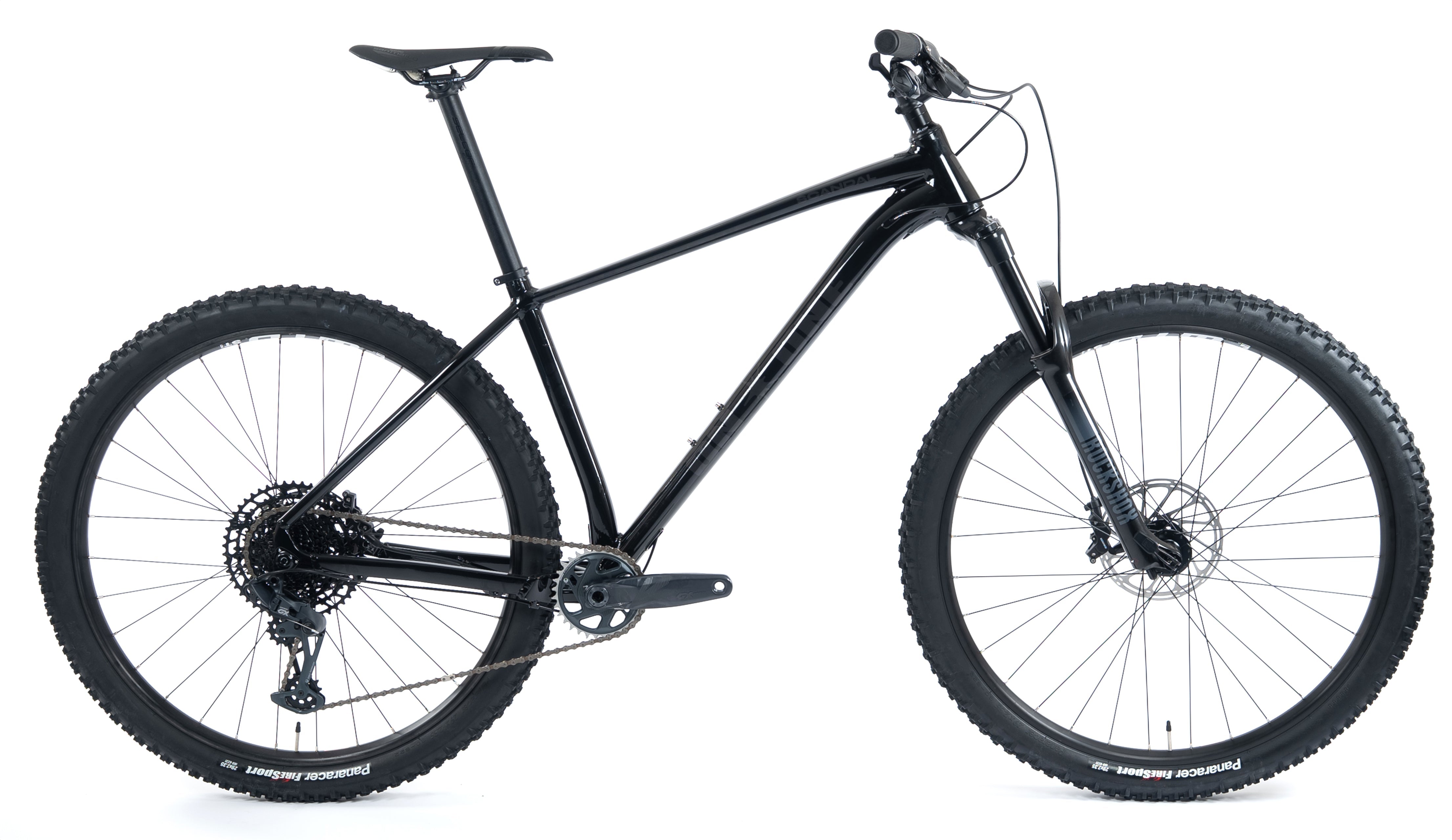

Sounds like a hardtail would suit you best, yeah.
Great time to grab a used bargain.
Or maybe one of these with the Pike upgrade for £1,050:
https://planetx.co.uk/products/on-one-scandal-sram-gx-mountain-bike
