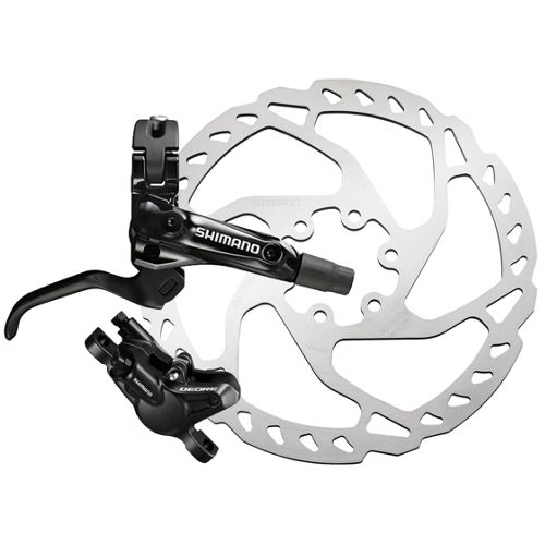

Ive finally finished building this up and put a 160mm rear disc on the back as per what it would come with from On one.
However , the bloody thing is warbling like mad.
On closer inspection it looks like the pads are only hitting part of the disc..........
[URL= http://i2.photobucket.com/albums/y33/renton1/Mobile%20Uploads/IMAG0252_zps9asfgsxx.jp g" target="_blank">http://i2.photobucket.com/albums/y33/renton1/Mobile%20Uploads/IMAG0252_zps9asfgsxx.jp g"/> [/IMG][/URL]
[URL= http://i2.photobucket.com/albums/y33/renton1/Mobile%20Uploads/IMAG0253_zpsbqtbdvld.jp g" target="_blank">http://i2.photobucket.com/albums/y33/renton1/Mobile%20Uploads/IMAG0253_zpsbqtbdvld.jp g"/> [/IMG][/URL]
The brake is a standard deore model and the disc is a budget shimano one.
Any ideas what is going on here??

Unless you want to start filing the disc mounts, I'd suggest getting a 180 rotor and calliper mount, and file that down a bit.

I was wondering if it was a 180mm disc thats meant to be fitted?
It looks like its missing around a cm of the disc all round.
Posted : 13/04/2016 9:42 am
Posts: 66260
Some bikes with stupid rear postmount have stupid minimum 180mm rotors, looks like it may be one. First hardtail I've seen like that though...

Pretty sure they're not for 180mm discs, and the rear on my parkwood has never been a problem. Also, in the pic the rotor seems to fit in the caliper correctly, so might it not just need a bit more bedding in?
I used those rotors on my road bike and noticed a similar thing, I think they need a tad longer to bed in and then they're fine. I don't remember having such a warbling problem, that might just be alignment?
The other thing is to check it's seated all the way in the dropout, i have to do a little shuffle to check this on mine..?
Posted : 13/04/2016 9:56 am
Posts: 1617
Looking at the wear on the disc you are about 4-5mm out. I fear that looks like the brake tabs are not right.

Does the friction material on the pad match the extent of the wear we can see on the disk? As has been said - does it just need bedding in?
A picture from behind would help.

This shows the difference between front and rear hopefully...
Front ...
[URL= http://i2.photobucket.com/albums/y33/renton1/Mobile%20Uploads/IMAG0254_zpsfiwf2hsj.jp g" target="_blank">http://i2.photobucket.com/albums/y33/renton1/Mobile%20Uploads/IMAG0254_zpsfiwf2hsj.jp g"/> [/IMG][/URL]
[URL= http://i2.photobucket.com/albums/y33/renton1/Mobile%20Uploads/IMAG0255_zps76hosjwz.jp g" target="_blank">http://i2.photobucket.com/albums/y33/renton1/Mobile%20Uploads/IMAG0255_zps76hosjwz.jp g"/> [/IMG][/URL]
Rear....
[URL= http://i2.photobucket.com/albums/y33/renton1/Mobile%20Uploads/IMAG0256_zpscrpb5cme.jp g" target="_blank">http://i2.photobucket.com/albums/y33/renton1/Mobile%20Uploads/IMAG0256_zpscrpb5cme.jp g"/> [/IMG][/URL]
[URL= http://i2.photobucket.com/albums/y33/renton1/Mobile%20Uploads/IMAG0257_zpsoleotz3k.jp g" target="_blank">http://i2.photobucket.com/albums/y33/renton1/Mobile%20Uploads/IMAG0257_zpsoleotz3k.jp g"/> [/IMG][/URL]
The rear disc sits a bit lower between the pads.

Strange - it looks less than the difference between a 160/180 disc. Tried loosening the QR and slightly splaying the non-drive side against the hub to check it's fully home in the dropout? I know it's patronisingly obvious but mine is susceptible to this...

That is odd. Daft question but I'll ask it anyway - those calibers are not front / rear specific are they?

I'm pretty sure a caliper is a caliper in that they are front or rear specific.

There is a rotor compatibility chart on shimanos website, have a look as you might find that caliper is not compatible with that rotor.
Edit it's towards the bottom of this
thread
http://singletrackworld.com/forum/topic/disc-brake-pads-too-low-will-i-die-after-sticking-some-washers-under-caliper
Posted : 13/04/2016 3:18 pm
Posts: 42157
It's not a 150 rotor or something daft? Shimano did used to to 150/160/170/180 to allow for some of the weirder setups (trying to run IS calipers on a post mount frame being top of the list and requiring a 10mm addapter).
Posted : 13/04/2016 3:56 pm

Have you got a 180 disc laying about somewhere or cut one out of card just to see as I think that's all it needs.....

probably easiest to fit a 180 rotor and some washers to space it up. Looks like the upper mount is the one that is wrong.

Well, someone had to say it! Trying it with your 180 rotor is the next step as suggsey said, no point thinking about it more til you've done that. With no adaptor. If that doesn't work either then it's Legendary On One Build Quality.

Ok so I've just tried a 180mm disc and that doesn't fit.
It's much to big.
I've got another 160mm disc on the way to try.

Sorry what I meant is that I think the disc I have isnt compatible with the caliper.
Its an rt54 alivio disc.

BR-M615 is not listed as compatible with the RT54, if that is what you are using. (But that might just be the pad material)
