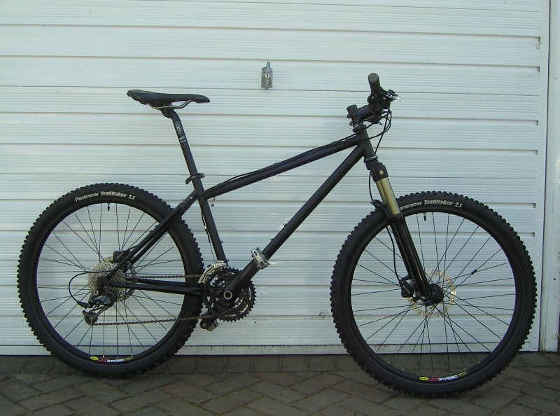

built this as a general tw***ing about bike with stuff out of the garage and ebay and it rides realy nice, but the head tube is very short and i need about 45mm of spacers to bring the bars up to the right position, its a 18inch frame, the seatpost looks long but its still below the min insertion line (400mm post) i tried a 20inch but it felt like a gate and this feels right, normally ride 19inch frames (soul, 5spot) with 10-20mm spacers on the steerer tube
so on owners anyone else with the same

That looks like a 16". The head tubes are really short hence the high rise stems on the on one site. This allows you to run a short fork with a high rise stem or a one several inches longer with a flat stem and keep the bars in the same place.

definatly 18inch, or so the tape says

i thought it looked smaller than a 18''.

just checked again in case im going mad defo 18inch, if it was 16 id need to weld some more seatpost on

Regardless of what size frame it is, it's obviously too small for you.
Inbreds do have a long TT, so I can imagine that the 20" might have felt too "long".
All that proves is that you need a different frame altogether, one which isn't as long for it's height (if that makes sense).

What druidh and Doug said.
You've bought the wrong frame IMO.

Also minimum insertion lines on seat posts only apply to the post, make sure you have at least 1 inch of post below the seat stay / top tube welds, if you haven't you'll break the frame.

it rides realy nice, seatpost do's look loooong but as i said its still below the min mark
but the headtube is tiny
Posted : 02/04/2010 1:47 pm
As I said that applies to the post not the frame, as above check the amount in the frame.
Posted : 02/04/2010 1:49 pm

the post go's lower the the seat/top tube

Bar height's just personal choice - I've got a pair of 18" Inbreds with at least that much seatpost showing, and with sus forks I use a 100/0 stem and with short rigid forks a 110/25. Shouldn't worry about it - yes the head tubes are short, but it gives you the choice of how to set it up provided you don't mind the aesthetics of the spacers.

not ignoring any one, just wondering if any other on one owners have the same thing with their bikes
Bez-thank you i'm not alone then,

Forgive me if I'm wrong, but that looks smaller than an 18". Where are you measuring from and too? Have a look at On One's [b][url= http://www.on-one.co.uk/i/q/FROO26INSLT/on-one-inbred-26er-slot-dropout-frame ]website[/url][/b] - the sizing guide there (take a look at the geometry tab) to get an idea, but the angle of the seatstays looks too shallow for an 18".
Also, I'd reiterate the need to have the minimum insertion way down the seat tube on such a frame - as you've got a lot of seat tube going above the top tube.

center of bb to top of seat tube is 18 i've measured it 4 times now with 3 different tapes and a 1 meter metal ruler

No way that's an 18". After looking at mine and some of the others pictured I noticed that the TT on 18" seems to join the seat-tube slightly below where the seatstay does. Your's are the same height and the angle between them is far less (or appears to be on picture) than on an 18".

definitely a small frame (16") your tapes wrong

i've got a 16" summer season and agree with the others yours in defo a 16".
Looking at on-ones website, they seem to measure the vertical height of the seat tube (dimension E in link below), not the centre to top, which might explain it.
http://www.on-one.co.uk/i/q/FROO456/on-one-456-frame
I was about to say, get the size up and put a slightly shorter stem on it to get the reach the same, but just noticed on on-ones website that both thw 16" and 18"s have 105mm headtubes, so that wouldn't raise the front end.
So, as someone above said, if you don't like all the spacers only option is a higher rise stem.

As everyone else has mentioned, that is definitely a 16" frame.

its a funny shape if it is a 16 (which it probably is reading above posts) it do's look different to the 18s above, i tried a medium 17inch soul and a 400mm post was'nt long enough to go up to peddling height and i got a L 19inch thats perfect with a 400post same with the 5spot
are on ones a funny shape then because thats a 400post and it go's up to peddling height ok and the post is still in the frame below the seat/tt juntion
not a 456 btw its a old inbred 80/100mm fork version thats had new stickers/paint

Y'know, looking at the seat stay/top tube/seat tube intersection has got me wondering.
This is my old 16" Inbred (also an older 80/100mm model.
Note that the seat stay joins the seat tube [i]above[/i] the top tube join. Yours seems to join at the same height

Note that the seat stay joins the seat tube above the top tube join. Yours seems to join at the same height
A Trait of the 456 as opposed to "normal" and 29er Inbreds, rather than a trait of the frame size...
Khani, yours is a 16" frame by the looks of things, not an 18". I'm a similar size to you, at 5ft 11 with a 33" inside leg, so I always need a long post too, minimum 400mm post on a 16" frame and at least a 350mm post on an 18" frame in order to get the saddle the correct height.
On the bar height front, there are 2 options to ditch the spacers and get the bars at the height you want them, both of them buck current fashion trends though... Get yourself a high rise stem (not my personal preference), or get yourself some nice 3" rise bars on there!

it do's indeed join at the same height and your one clearly dos'nt,
like i said it rides nice so i'll see how it go's
Posted : 02/04/2010 3:17 pm
dos'nt matter now, the mrs read the thread and dropped the seatpost and lowerd the stem, took it for a ride, and took it off me, says it rides nicer than her bianchi carbon ouetzi and she's keeping it 😯

The headtubes are very short and IMO you don't have a ridiculous number of spacers on it

as TJ says, On One have very short head tubes. I swapped the forks and parts from a 17" kona to a 16" 456 and needed 40mm of spacers to get the forks to fit (from memory kona 120mm, 456 80mm headtubes).
I'm 5'10 with a ~32" inseam and think the 16 fits me perfectly. 5'10 puts you on the cusp of both 16 and 18 so whichever youve got it should fit.
