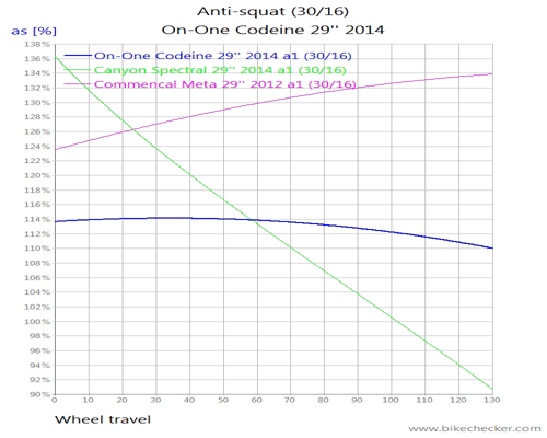

The Codeine does have a ton of anti-squat regardless of how deep into the travel you are:
http://2.bp.blogspot.com/-k4UN7QT7_74/U2p0urrd19I/AAAAAAAASzo/3_954lBNhrE/s1600/On-One+Codeine+2 9''+2014_Anti-squat.gif
On the other hand the Phantom has similarly high anti-squat when you're around the sag point or lower in the travel, but as you start hitting things and compressing the suspension then the anti-squat diminishes:
http://3.bp.blogspot.com/-AA5TgxLnEug/U2WFsuQ-IFI/AAAAAAAAStA/qOMqZqflW70/s1600/Banshee+Phantom+2 9''+2014_Anti-squat.gif
All the KS-link Banshees are like that.
