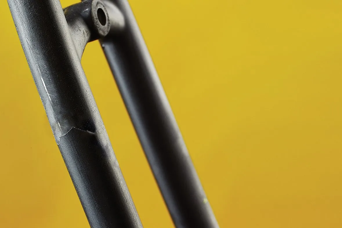

I fancied lightening up my road bike so shopped for some carbon bars. I'm fussy re shape and only found 1 set I liked the shape of, they were cheap at $44 but not ridiculously light at 250gm so thought I'd give them a go.
They creaked under the slightest leverage in my hand before I fitted them. I complained with a video and got a refund, then tried to pull them apart, which I managed by hand. They came apart just here the levers clamp on, seemed to be made in 3 parts.
https://photos.app.goo.gl/IlGElpoK3hxpv9v32

I've got to say that's quite shocking - that price is cheap but not that much less than you can get some carbon bars online (maybe not drops). I would only buy through reasonably trustworthy sources, i.e. online shops selling brand names - doesn't have to be top names but at least someone who is putting a reputation out there that could be ruined by some failures!
Posted : 10/04/2018 10:35 am
At least they were knowingly cheap no-name (I assume) bars. Could easily have been one of the many big name brands on Ali that are fake and deadly.

Will give that video a watch.
It's like being trapped in a small room with a Just A Minute contestant speaking on the subject of handlebars. It's kind of a response to a GCN vid  comparing carbon and aluminium drops.
After some judicious skimming, the main points seem to be that:
1. Carbon bars - decent ones - are more resistant to fatigue than aluminium ones, but aluminium has improved since manufacturers stopped making them silly light.
2. Some carbon bars are made in three parts so they bond the drops to the tops allowing them to make different bars from some common parts - potential weak spot.
3. The most common failure point for carbon bars in an impact is at the rear of the stem clamping area. The GCN video features an impact test with force applied from above, but in most real life cases, it's a frontal impact and the stem clamp area is where the force is concentrated.
4. Avoid stems with sharp edges to the clamp, there's enough movement in bars to cause scoring in those areas and potentially weaken the bars. He suggests using a Dremel or similar to smooth off any sharp edges on the inside of the clamping surfaces.
5. He himself, he says, mostly uses carbon bars, but the advantage of a relatively cheap aluminium bar is that if you do crash hard, you can simply throw it away and buy a new one, whereas with an expensive carbon bar, the temptation is to keep using it.
6. X-rays are sometimes the only way to spot structural damage in carbon - and aluminium bars - and maybe worth getting done with an expensive carbon bar if you've crashed it.
Most of the useful stuff is around the ten minute mark.
Consider this a service to anyone who finds themselves unable to watch the entire video. There may be other stuff I skimmed past as well, but as I skimmed past it, I don't know... it could use a serious amount of editing.

Good question. Google brings up an ancient STW thread which includes advice from Colin who works/used to work at Trek saying:
x- rays may show internal damage, but the only true test is a non destructive ultrasonic resonance test. This will be a 100% accurate
Or.. in Germany:
http://www.carbon-bike-check.com/index.html
cited in  http://www.cyclist.co.uk/tutorials/105/how-to-assess-a-cracked-carbon-frame
which says: 'The process uses a combination of heat, ultrasonics and hi-resolution thermal imaging'.

Yeah seeing internal damage on carbon is essentially a tricky endeavour.
Internal damage/small cracks on alu is similarly tricky to find within the bounds of the equipment most of us have available anyway.
I'll have to use the "floor mangling" test in future.

I think you might be the exception to the rule. The Chinese are typically better than the west at carbon fibre manufacture and are very experienced.  There's obviously a line to be drawn somewhere about cost / quality and I think you've probably found it in those bars.
Look at the price range for carbon stuff in the UK. Seatposts*, for example, range from ~£30 to upwards of £300 with no obvious difference in quality and potentially made in the same factory.  I'd be fairly relaxed about riding on cheap-but-not-dirt-cheap Chinese carbon (in fact, I do, on my Ribble...), especially having seen a couple of web-tours around the factories.
* Admittedly, that £30 seatpost broke last week and I've just replaced it with one costing £100.  I don't know if the low price is related to the failure or not, but my replacement decision was based on the fact that I needed a replacement same day, hence paying through the nose at my LBS.
