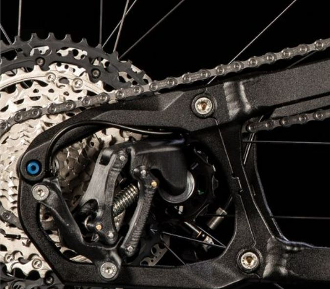

Posts: 21180
Unfortunately the need for additional pulleys and the potential maintenance etc that comes with it
‘All’ he’s done is move the lower mech pulley wheel to next to the chainring. No more than any other high pivot/idler setup.
Is it actually proprietary, or just a modified shimano?
I think the way it mounts to the frame are the unique bits.
Posted : 12/07/2022 4:06 pm
Posts: 14040
DaveyBoyWonder
The extra pulleys are in a large part relared to it being high pivot though - hard to draw a line between the high pivot and the drive - there's a tensioner pulley replacing the mech cage, other than that, it's sort of a "normal" high pivot
Posted : 12/07/2022 4:12 pm
Posts: 14040
tomhoward
You can see it in this pic, hard to tell, looks like an XT but the outer pieces look custom.
Mostly curious as to whether they have gone deep enough into the design to build their own mech.
