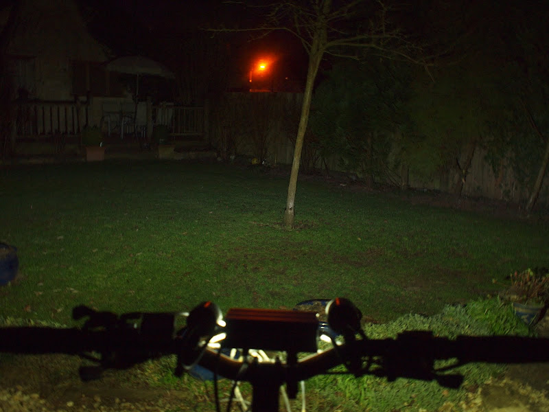

More of an update to an existing set really.

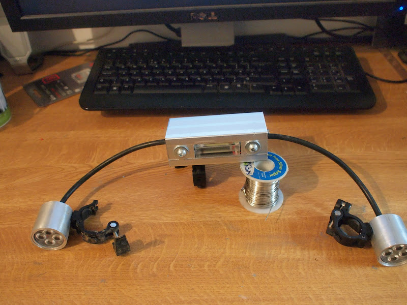

I've got a pair of quad xp-g r5s (1480 lumens each) that did have an external switch/controller housing which mounted to the stem. A new frame (and shorter stem) meant the old switch units had to go. So... I added a bar mounted box and stuck in another LED, for no good reason other than I could (the selection criteria being that the LED was oblong).

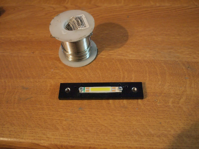

This is a 7W COB (540 lumen):
This is the the complete unit (6 degree lens on the COB and 23 on the quads):

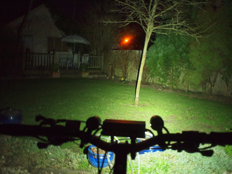

And some beam shots (base on the old MTBR standard but ISO/shutter balanced to avoid a tripod).
Base:

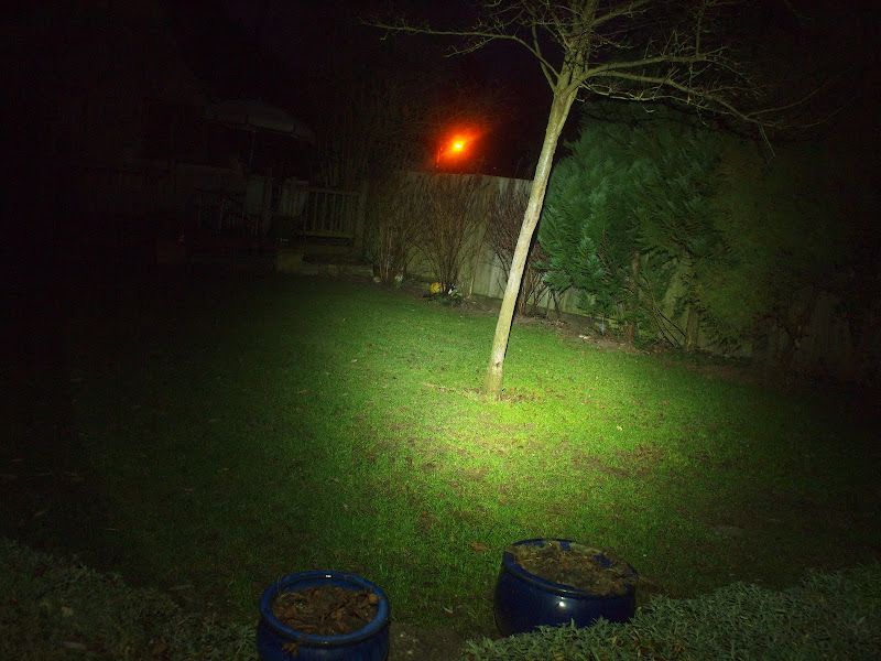

COB only:
One of the quads:

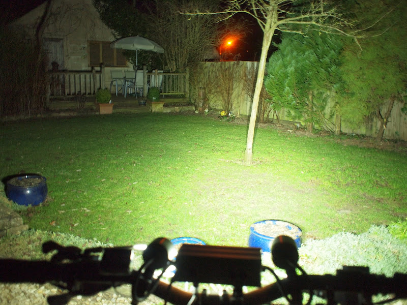

Everything:
And for rerence...
P7 with 15 degree optic:
Twin xp-g with 10 degree optics:

crikey you burnt a hole in the distance
Posted : 29/01/2011 7:33 pm
Think that hole is hope testing their new rear light on the moon?
