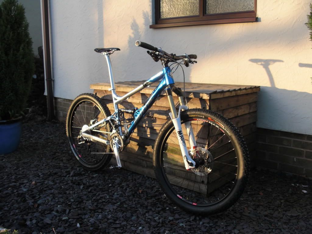

Here you go:
[img] ?t=1269071254[/img]
Please feel free to criticise house and "garden." (as if anyone needed telling).
Yes, I know about the cockpit - it's a work in progress so has a lot of adjustment built in whilst I decide just how low to go...

do u get a nose bleed sat up there on that long seat post?
can't really see the bike though to comment, any side on better pics?

It's a low frame, the seat tube is under 17" so the post looks longer than is really. Meant to get some better pics, but they were all done in a hurry, and they all came out a bit pants. How about this one:

I like it. It's suprising that Banshee/Mythics aren't more popular, the Rune looks like a nice frame too.
I like the long/low slung geometry too. So many bikes these days have long ST's and short TT's.

Oooh I've been looking at getting one of those.
- How long are your forks?
- What headset are you using?
- Is there clearance between fork crown / downtube for them to turn 90deg (e.g. crash / lying bike in back of car etc)?
Ta
Posted : 20/03/2010 11:38 am

@tang: The seatpost is a Thomson 410mm laback - got a good deal on wiggle, about £50.
@mr_mills: The forks are 140mm travel, 520mm atc. The headset is a Hope, zero stack upper cup with a 1.5" to 1.8" reducer lower cup. I'm running the external variant of the reducer cup to add 10mm to the stack height, preserving the geometry. The bike is set-up to crash! Those bars can spin 180 without anything hitting or tearing loose. I don't crash that often anymore, but when I do it's spectacular.

Hmmm so if you had zero stack height on the bottom cup would there not be enough clearance? I think the Freeborn site says 160mm forks need zero stack height. I was thinking if I got one I'd put Talas 36s on, but not if I can't crash!

It wouldn't worry me to build it with 160 forks and a zs lower cup. I'm sure there are some people on the Banshee Forum on MTBR have done that:
http://forums.mtbr.com/forumdisplay.php?f=155
I'm pretty sure the designer (Keith Scott) wouldn't have dropped a clanger like that. I can measure my clearances for you, if you like? If you're really concerned, Hope do various thicknesses of crown race to get around this potential problem.

mttm - did you get a Hope headset with a zero stack 1 1/8th top cup and 1.5" lower cup? I know about the reducer headsets as I've already got one - where did you get this from?

Hope will sell you a "Combi" headset, allowing you to specify any top and bottom cup configuration you desire. This isn't terribly clear from their website, but a quick phonecall to Hope clarified it. I ordered mine through my LBS.
