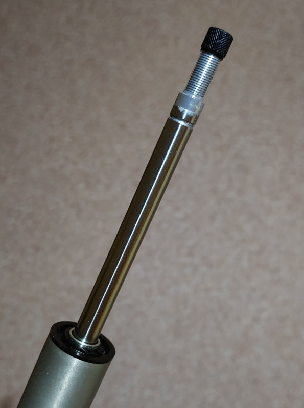

Hi,
I'm trying to repair some 454 Air U-Turn Pike forks and found that the threads appear to be damaged on the air shaft foot/end. Not sure how but when I inflate they leak air from there. Is this likely? Can they be converted to coil or should I scrap them? Or does any kind soul have an old Turn Air setup that I can purchase?
Thanks
Chris

Threads were chopped up on the outside so in my infinite wisdom I filed them off.
Changed the valve core first up and didn’t help.
When I inflate the negative chamber I can hear air coming straight back out around the valve/thread area.
I can get a new lower air assembly from US, but keen to see whether I can sort it diy.
Thanks

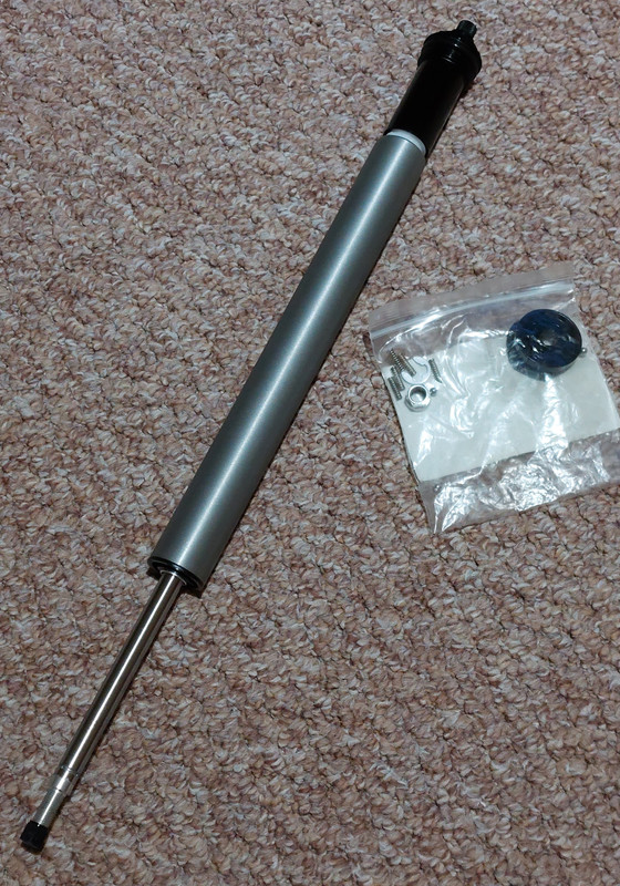

Probably a completely useless offer but I have a spare Revelation 426 (140)) air spring that holds air that you can have for nowt if the parts are of any use.
Posted : 10/05/2022 1:18 pm
Posts: 1735
Thanks all. Might go and tinker with some PTFE tape. However, @VMGSCOT - think I may take you up on your offer!

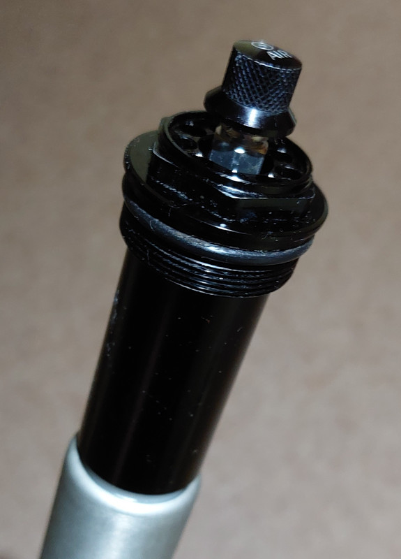

Here's what I have @cjr61 ... its a complete air spring side 'cartridge' out a Revelation 426 U-Turn Air (2009?). Still holds air and has all the bits for the adjuster knob, valve caps, footnut.
Posted : 11/05/2022 9:49 am
Posts: 1735
@vmgscot - that is absolutely brilliant! You’ve made my day
Thank you

Posts: 1735
They're super easy to work on. The air spring @vmgscot sent over has done the job perfectly!
Top STW support as always
