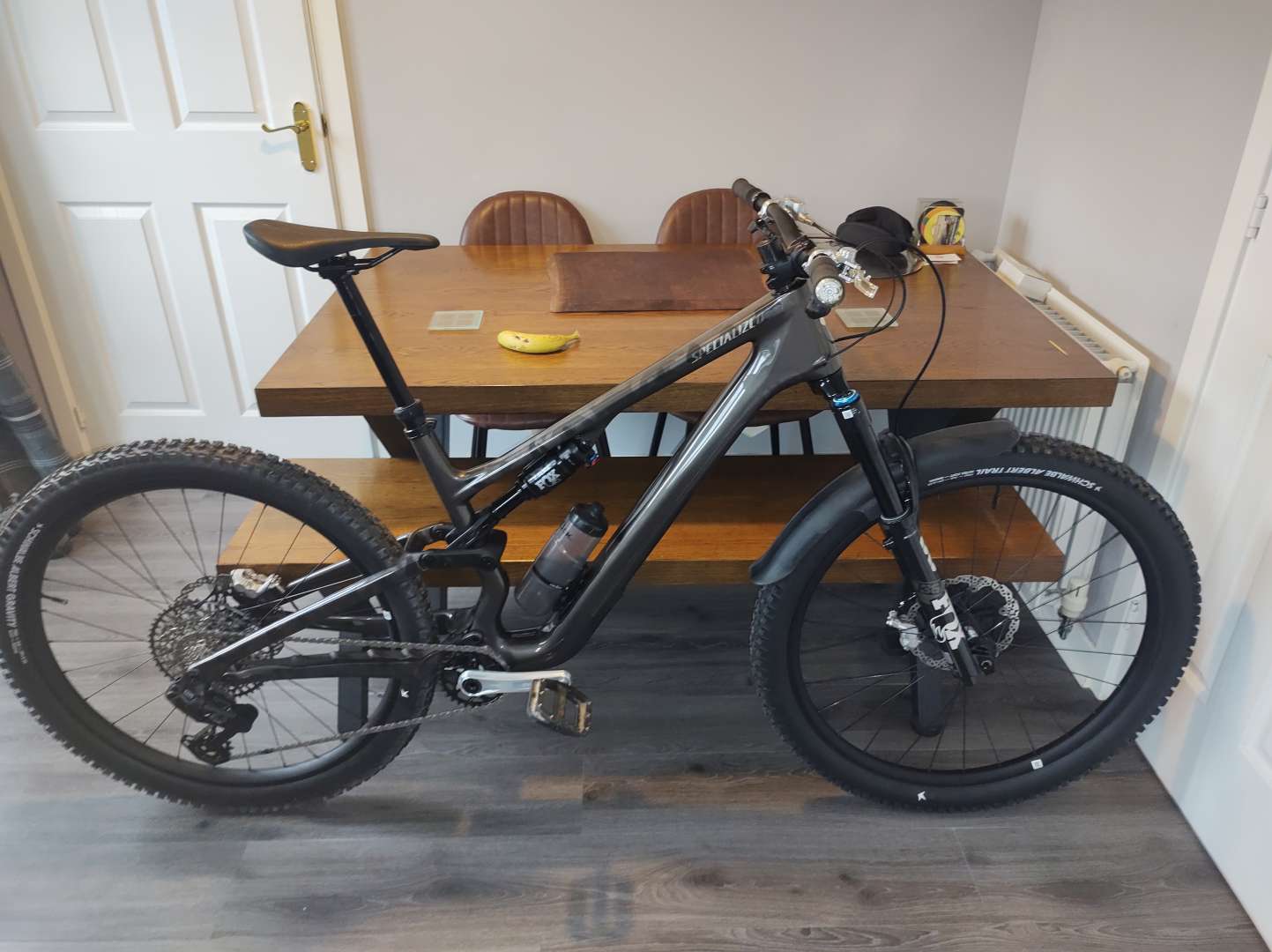

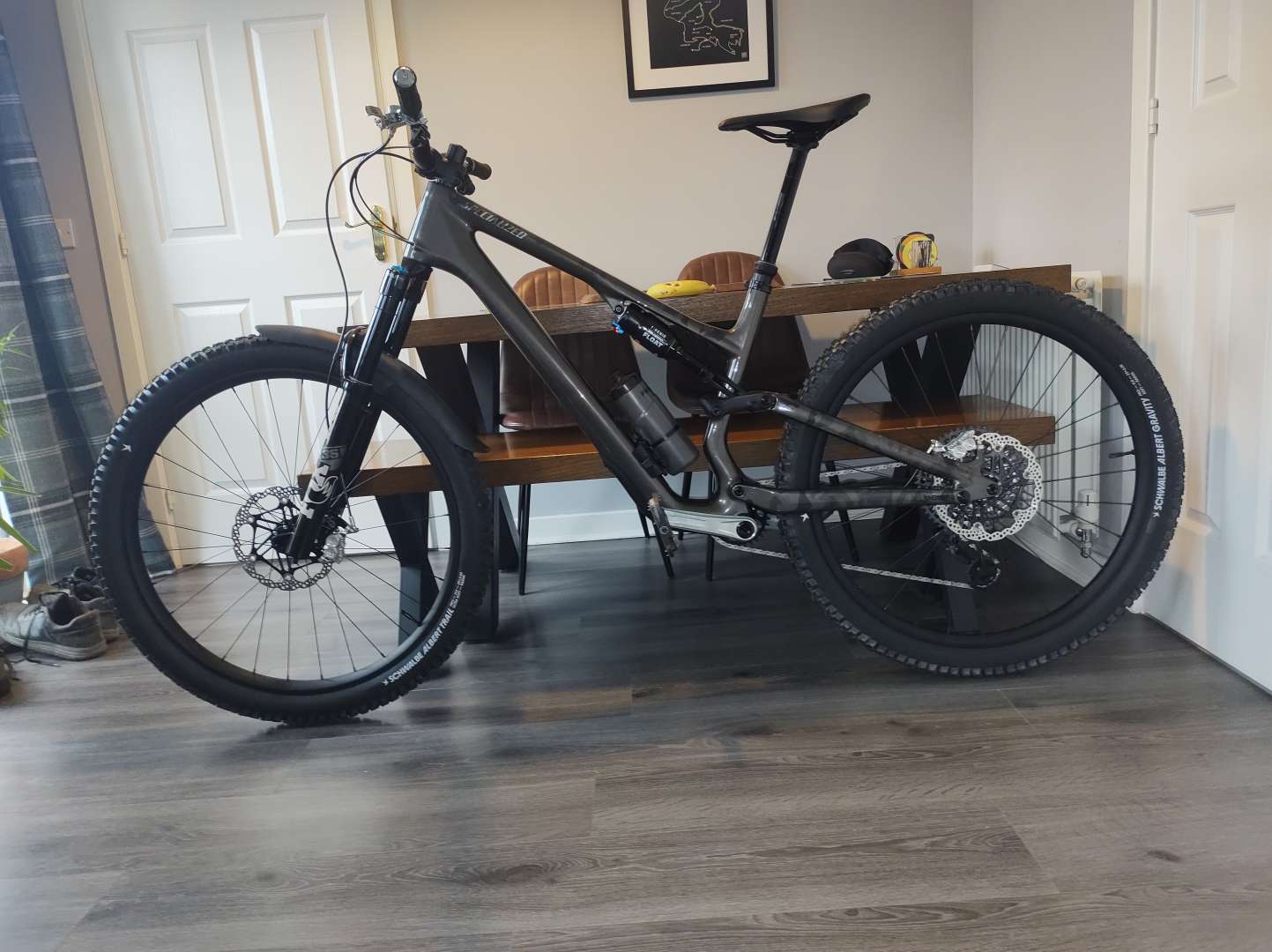

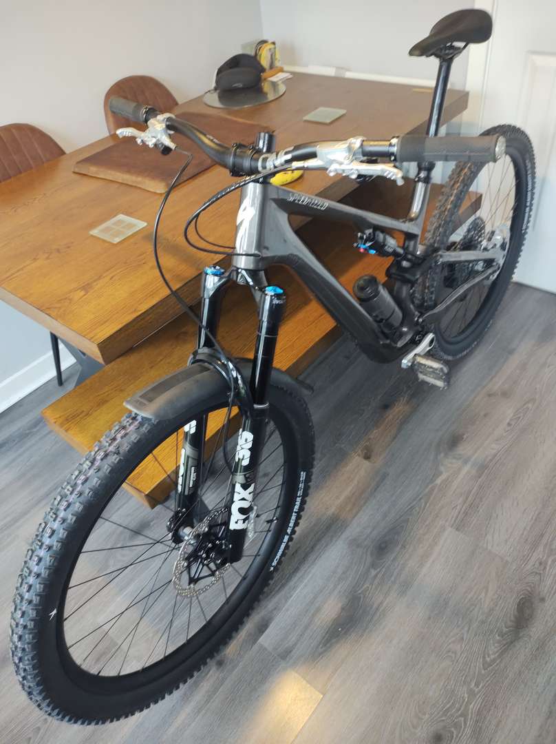

New Bike Day for me last Friday.
Been busy riding other bikes so only just got round to posting this up.
Stumpy15 Expert with a few bits swapped out.
Not a massive fan of SRAM brakes so despite the Mavens feels ok on the test bike I tried I went with my go to brake of the moment the Hope Tech 4 V4 .

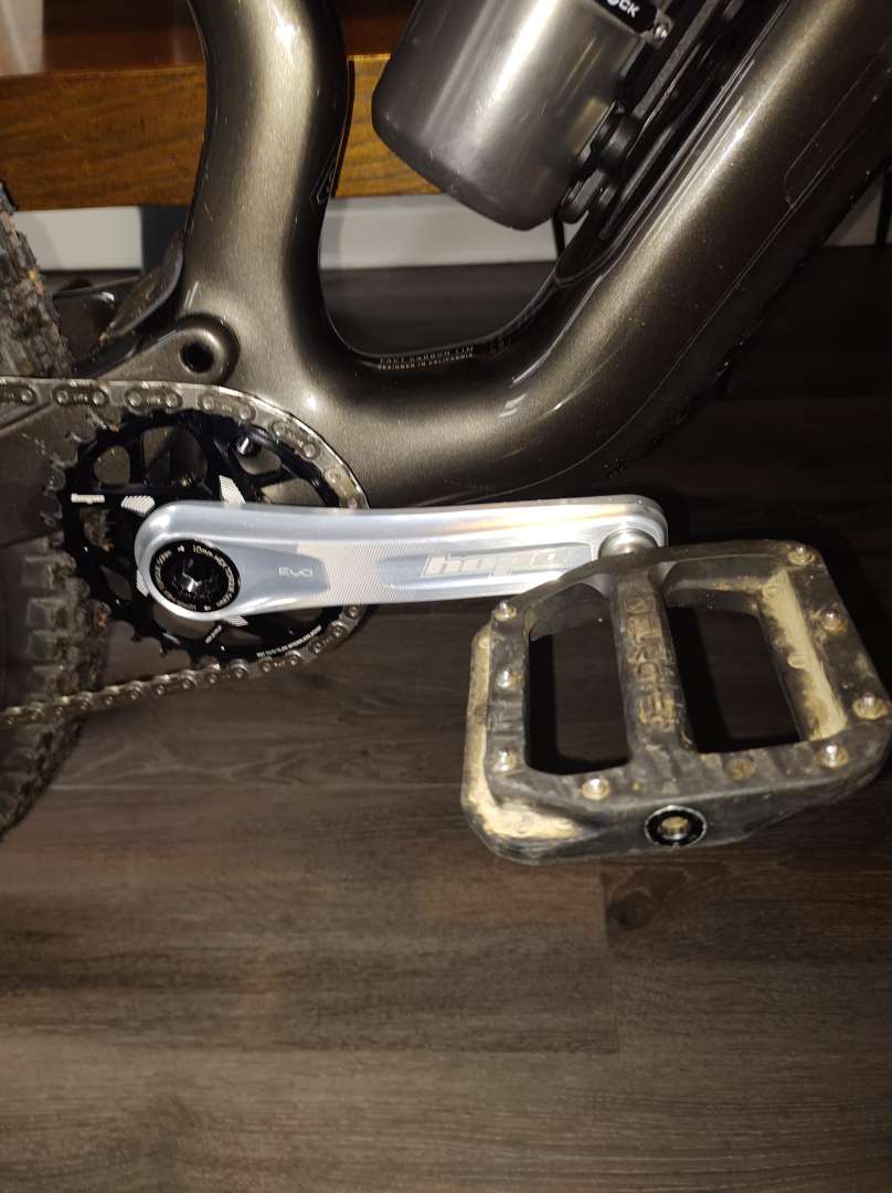

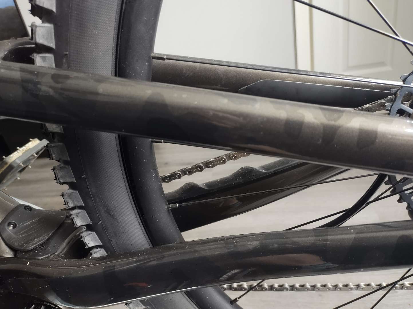

The BB is pretty low on it and after having a few pedal strikes on the test I went for a shorter crank. Hope 155 mm and lowered the gearing from a 32 to a 30.
Not 100% sure if I'll stick with the 30t as the chain is pretty close to the chainstays. If it turns out to be a bit slappy I'll jump back up to a 32.
Also had to have a new BB to fit the crank so went with a Hope for that too.
Had a tyre swap to Alberts, Trail Utrasoft front , Gravity Soft rear.
Fitted my bar of choice the One-up carbon.
Slapped a Dyebros frame protection kit on it and then gave it a Gtechniq ceramic coating treatment.
Not going to ride it until later in the week to give the ceramic time to bond to the frame properly.
Just had a very quick spin round on it and taken it off a jump the junior division of the local Endurobros have built at the back of our house to get me started on setting the suspension up.🤣

If I'm being picky, the trainers on the floor need tidying away, and the curtain to the left of the door is not hanging quite straight.
Nice bike.

Other than less strikes, do the 155 cranks feel different? Or is it not really noticeable?
Posted : 09/06/2025 5:46 pm
Posts: 17783
Posted by: Tom83
Not really much different to me but I do have 155's on my Eeber so I'm used to them from that.
Rode my Enduro bike this morning which has 165's then when I jumped on this it didn't really feel that different. It's more noticeable switching from 155 back to 165 for some reason.

Nice bike, is the genie good or a novelty?  Sounds like a good idea on paper
One gold star to whoever left you a decent amount of steerer to play with.
Posted : 09/06/2025 6:23 pm
Posts: 17783
Posted by: Rubber_Buccaneer
I'll let you know after I've played around with settings.
The test ride left me confident I could get it working well for me but time will tell.
Got a bag full of Genie spacers as well as end stroke ramp up spacers to experiment with.

The 155 cranks have totally removed any pedal strike problems and don't seem to have affected the power to any great extent.
