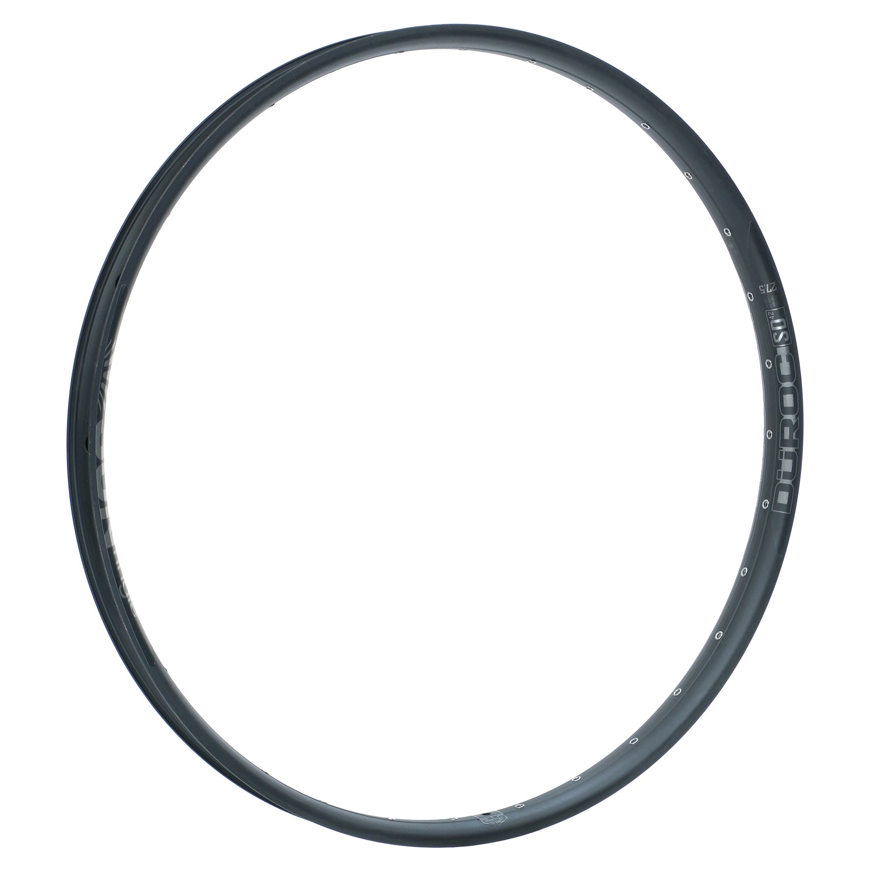

Some people above mentioned Maxxis tyres with the WT suffix, I feel there is an important point being missed here.
Maxxis developed these tyres for Wide Trail ie 35-40mm rims, and people like hunt, sun ringle, stans etc all produce enduro rims for WT tyres. Typically 2.3-2.5 width.
Thus your 40mm rims will probably be fine with a set of WT tyres.
They will probs be fine with any old tyres but those ones are at least designed for wider rims, without needing 3.0 width.
https://www.maxxis.com/wide-trail-wt-design
https://www.huntbikewheels.com/products/hunt-endurowide-mtb-wheelset?
https://hayesbicycle.com/collections/sunringle/products/duroc-sd42-rim
Posted : 30/04/2021 3:48 pm
