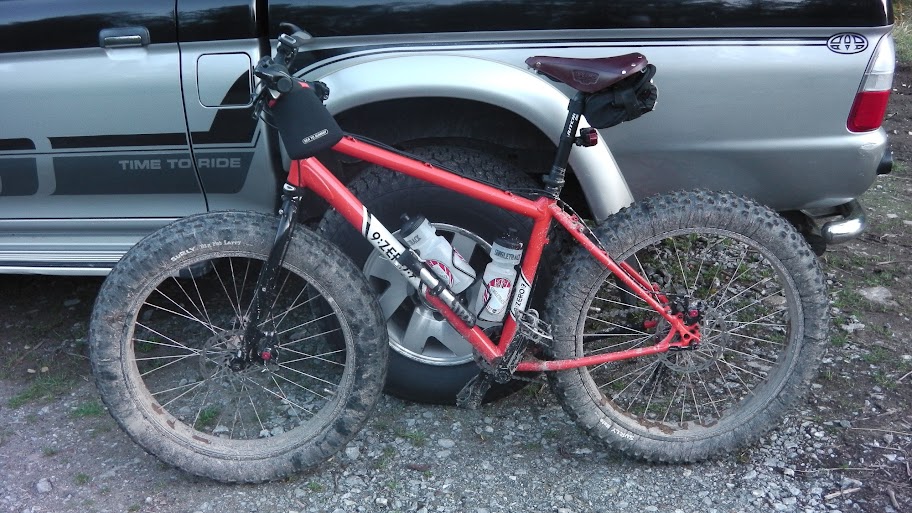

Ive had a pugsley for 2 years, use it mainly for singletrack riding, some of which is quite sandy around here, plus I love different bikes, these are just like riding a geared bmx to me, and soo much fun
I know some haters say they dont make sense - thats fine by me - they dont need too !
spec -
sm 907 frame
white bros snowpack carbon fork
hope headset
hope pro II hubs
VIZ rims 47mm
middleburn rs8
Xtr gears and brakes
Titec H bars
easton carbon seatpost
Charge Ti spoon
Im running continental 1.9-2.1 superlight tubes at the mo
The idea of this was to build a lighter weight fat bike to replace my pugs
Weighed on my digi bathroom scales its 28 lbs - including these pedals and a Nate on the front
So realisticly I caold see it gettign down to 27 in summer - but I think you wouldnt get an Alu framed fatbike any lighter and still be running a triple up front
8 miles through the woods on way to work this morn, 15 night ride after work - will see how it gets on
Rear wheel needs 4mm more dish, will be getting a white marge lite in there v. soon,along with black bar tape, thought orange would look good but its too much

What pressure do you run your tyres at? And how is it to ride? Do the tyres feel like they really drag?

Did you re-drill the rear rim for off set?
Philwood BB or source something more affordable?
<Ispy book of bike builds out > What pedals are they?
personal preference - black saddle for snow 🙂
Posted : 26/10/2011 8:50 pm
 cozz
err, rear guard stops mud spraying up me back
yeah you can see the rear light
yeah my floor needs painting again
rear rim is redrilled for offset, measured and drilled by hand
phil wood BB, cranks from ebay and then I polished them up
just them shimano spds with platform one side
got a Ti swift saddle but chucked this one on for winter
tyres around 10-12 psi at the mo - upto 18 for longer road rides, down to 8 for snow etc
riding it is like pedalling a monster truck

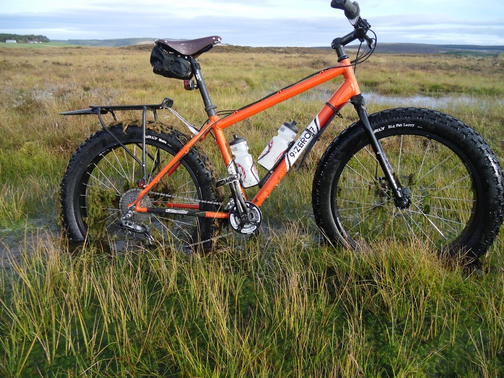

I've fitted a cheap Aldi rack (available again at my local Aldi right now under a tenner) on my fat bike and wrapped a plastic bag around it, it makes a great and cheap mud guard
[url= http://farm7.static.flickr.com/6239/6222437921_96c0d3d790_m.jp g" target="_blank">http://farm7.static.flickr.com/6239/6222437921_96c0d3d790_m.jp g"/> [/img][/url]
[url= http://www.flickr.com/photos/25655510@N02/6222437921/ ]October 8th - New Frame Bag[/url] by [url= http://www.flickr.com/people/25655510@N02/ ]Johnclimber[/url]

What's the rack??
