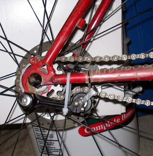

your tensioner is pushing the chain down at the moment.
if your chain is the right length, the spring can be reveresed, so the tensioner is under the chain and pushes it up, towards the chainstay.
this is cleaner
gives better clearence
and wraps more chain around the sprocket, which is a good thing
[img] [/img] like this but with no ziptie, and better looking...

The tensioner working up allows more chain in contact with the sprocket thus won't slip.

aha - i have the on-one tensioner - perhaps i can perform the same mod as shown above then ?
and WTF is a half-link ???????
Posted : 02/10/2009 4:19 pm
Its a link that is phat at one end and thin at the other, thus half the size of a normal link, this will shorten the chain by 1/2 a link

Without a half link, you won't get another link out of the chain. Mine looks just like that and I've only had minor slippage which hasn't ever caused me a problem.
One thing to watch with that tensioner: when it's really filthy, the jockey wheel can bind against the bolt holding it in and unscrew the jockey wheel. I've had it happen once with a really old one, and again at Kielder last month with a relatively new one. That's in hundreds of miles of riding though, but it's worth keeping an eye on it.

You could just use a half link chain- a much neater way of dealing with chain tension than a tensioner. I've used one on 2 bikes and my mate uses one too and they're perfect and make your bike look so much better.
