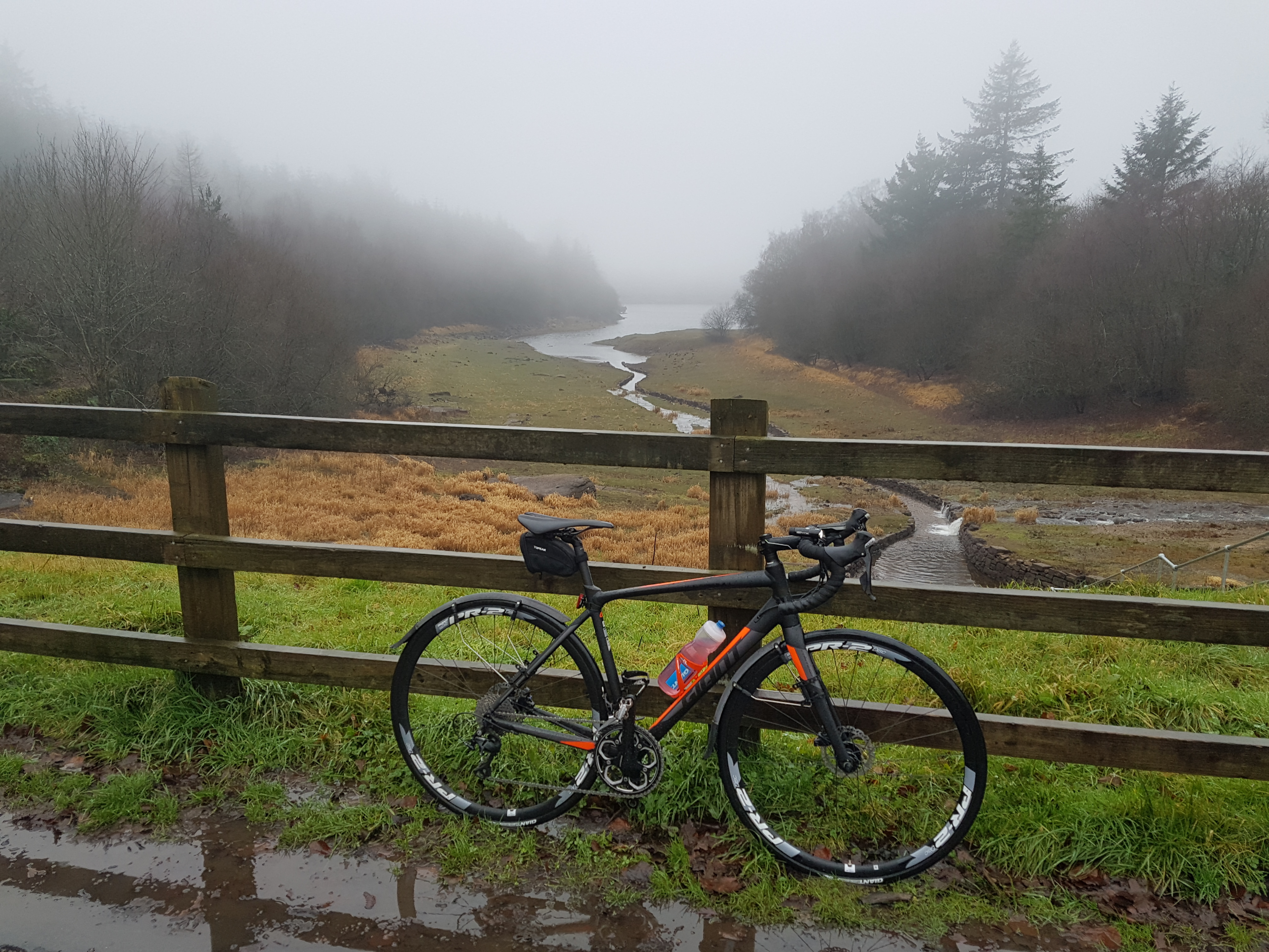

I got a Contend SL1 specifically as a winter bike, found out in the space of a few weeks that no mudguards actually fit it properly as (although they make a point of mentioning guard fixing points in the advertising blurb...) there is no clearance between tyre and fork crown, ended up using clip-ons anyway...
In reality though, these are the second set of Widget clip-on guards I've had, they really are very good, and the SL1 is otherwise also very good.
