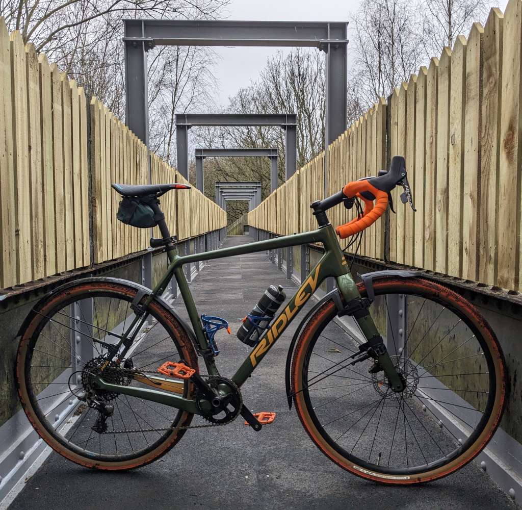

Posts: 8396
If you decide to go with SpeedRockers instead of Bluemels, this is some over 43mm GravelKings. No rattles and great coverage.
