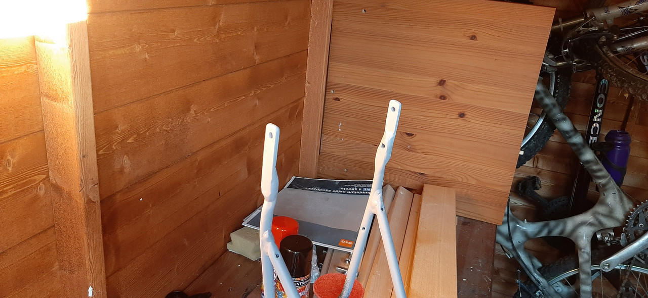

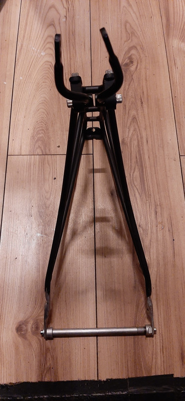

I've taken a turbo trainer skewer for a 142 x 12 bolt through axle thats the same pitch thread as my skewer and got a friend to weld some extentions onto the rack so it reaches the axle. Then drilled the axle and tapped a thread into it.
I primed and painted it to make it all match.
[url= https://i.postimg.cc/YS4rs9Bk/20210329-174456.jp g" target="_blank">https://i.postimg.cc/YS4rs9Bk/20210329-174456.jp g"/> [/img][/url]
Not suggesting anyone else should try this but thought I'd post a thread about it in case anyone else is made enough to try it. I'll let you know if I die. I'll keep the original skewer in my bag just in case.

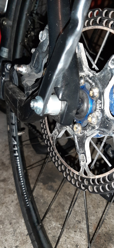

This is the axle through the frame and the bolts into the axle. Usual seatpost clamp adapter to secure the rack to the frame.

The training skewer sits on metal inserts just like the original skewer did.

Thats not putting any significant extra force on the frame.
Posted : 04/04/2021 5:01 pm
Posts: 3783
Thanks @tjagain. It's reassuring 😊
My worry is not the frame or my friends welding (he's a pro) it's the bolts into the skewer that will be the weak point but it's a beefy skewer. Time will tell.

Hard to say without knowing what size the screws are, but they're under shear stress, so probably ok. If they have the shank (un-threaded region) in the stressed region even better, also makes a difference what the material is, but I wouldn't be worried. Nice solution.
Just keep them tight so they can't bend.

@richmars they are full treaded bolts. They are pretty long, at least 2 or 3 cm into the skewer. Maybe 1 cm into nothing. I might see if I can pick up a bolt that doesn't have a full thread. Thanks
Posted : 04/04/2021 6:55 pm
Posts: 41395
Speaking from experience, make sure the bolts are hi tensile!
Otherwise looks great.

You should start a sweepstake on how long it will last before cracking the frame?
Why should it crack the frame? The load from the rack is straight down to the rear wheel. It's a method used by Tailfin and they also sell axles including a "universal" one.
