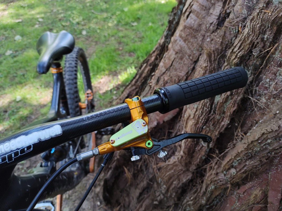

Posts: 3957
Initial impressions are good. Feels like there's a bit more power with the slightly longer blade, and that was with a 183mm rotor.
Will need to make a couple more mods to the blade or the cam as the reach is miles away even with the reach screw all the way out.
Posted : 02/06/2022 3:54 pm
Posts: 3957
Made some more mods to the lever and the cam and all's good. Not as light on lever feel as a real Tech4, but that could be due to the pistons and\or master cylinder spring.
Blade for the other side is ordered and I'll do some pics of the mods on that and the other cam.

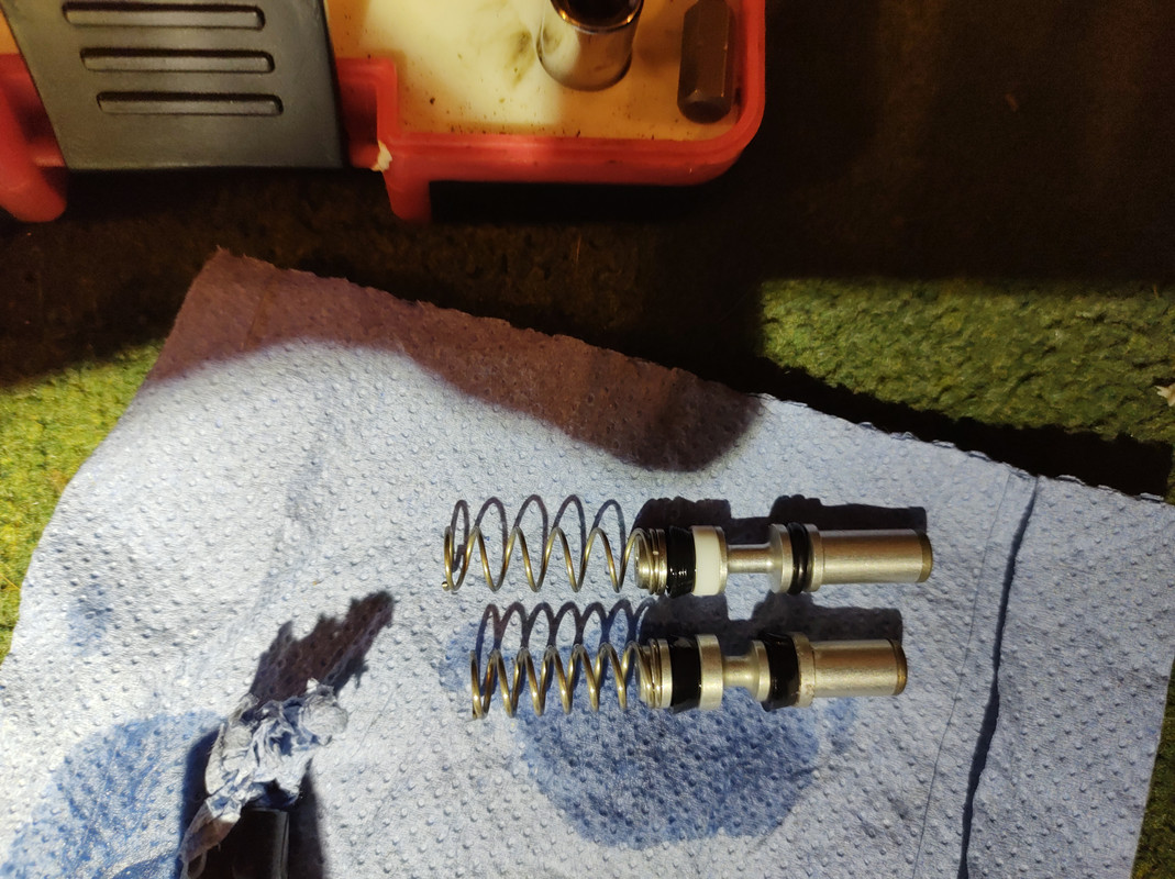

Another update. Just on case, like me, you were curious as to whether the Tech4 MC pistons fit the Tech3.
Been running the Tech3 master cylinder with the tech4 levers (and cams, which needed a drill as well as a hole drilling and tapping for the pivot grub screw) for a couple of months and they're really good. Lovely feel and seem to be a smidge moar power.
However, I thought I'd try the Tech4 MC listings as well... They totally don't work. They're a bit longer overall, and there's only one seal. The rear one is an o-ring on the Tech4, so the MC leaks. The spring is lighter and does fit, but can't feel the difference in the Tech3 MC.
Guess I now have spare for the inevitable Tech4 MC's I'm totally going to buy.
Hybrid pistons are on their way as well,
Posted : 11/11/2022 9:08 pm
Posts: 3957
[url= https://i.postimg.cc/pr5HGrfq/IMG-20221111-181334745.jp g" target="_blank">https://i.postimg.cc/pr5HGrfq/IMG-20221111-181334745.jp g"/> [/img][/url][url= https://postimages.org/ ]free picture host[/url]
Upper is tech4, lower Tech3
Posted : 11/11/2022 9:10 pm

Posts: 3957
Why did I do it? Why not
The main seal is the same diameter on each, and the rear is an o-ring on the 4. The rear seal on the 3 won't fit the 4 as the gap where it goes is too narrow. 4.also.has what looks like a PTFE bush.
4 a few mm longer in the rear slidey part but could be shortened.
Ordered some full Tech4 MC's now, anyway. Still cheaper than a full pair of E4
Posted : 12/11/2022 9:29 am

Posts: 3957
Finished changing the seals and putting the new pistons in. Makes a big difference to lever feel.
Had sticking issues when the pads were worn and there was loads of chips on the edges of some of them, so they needed doing.
Posted : 12/11/2022 7:53 pm

Take your time, squeeze the o-ring laterally and get one bit seated, then feed the rest in carefully with a pick.
Also, lube the pistons with Silicone lube or dot4/dot5.1 to help them slide in (this is important otherwise you might nick a seal and have to strip the bastard again, and possibly contaminate the pads 🤦).
Use the middle of an 8mm spanner to push the pistons in.
