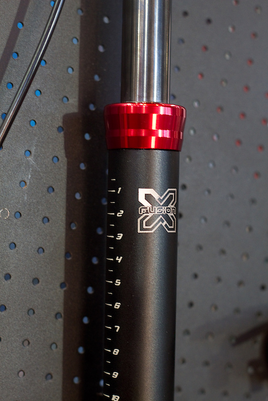

I need to lube the seal on my X fusion dropper post , USA tech dept says its Ok to take it off & grease, but I cant get any purchase to unscrew it. Its about 30mm dia. and a smooth anodized surface. Have tried a pipe wrench and tyre bodge but no shifty. Any ideas of using general things around the garage ? Don’t really want to use the vice for fear of crushing.
It’s the red bit-

Vice with soft jaws?

ONe of those things for old folks to open jam jars?
Drill a small hole below and grease gun?

+1 for al's suggestion, strap wrench should see it off ok.

Not a left hand thread is it? Probably not, but it's worth checking!

Boa wrench?
Or cut Vs in 2 blocks of wood and use those between the vice and shaft

a small memac will shift that - if you have one in your shed your a better man than i 😉

+1 for boa wrench - most DIY or motor mechanics shops will have them inc Halfrauds as you can use them for taking oil filters off 🙂

Also you can use them for opening stubborn air cans on rearshocks.
