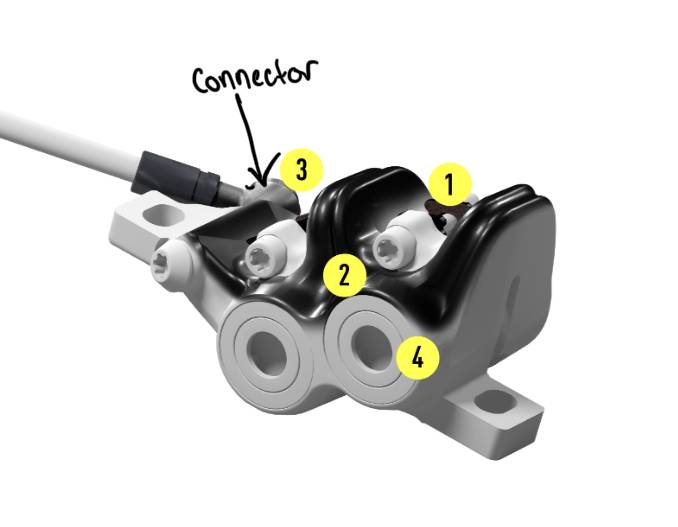

Hi,
I have a set of MAgura Trail Sports and a spare MT5 caliper - I’d like to swap the existing 2-pot rear caliper with my spare MT5 caliper - is it as simple as move the hose connector (below) from the 2 pot to the MT5 and then doing a bleed? Do I need the insert/olive for the MT5 caliper?
Gonna be shortening the hose at the same time, so will be ordering a new insert etc for the hose end of the lever.
Cheers

I did the same a few years ago and pretty sure the hose just swapped over to the new caliper with no mods that end.

Posts: 4142
Yep just unbolt the hose at the caliper end and swap over. Quick mini bleed and sorted.
