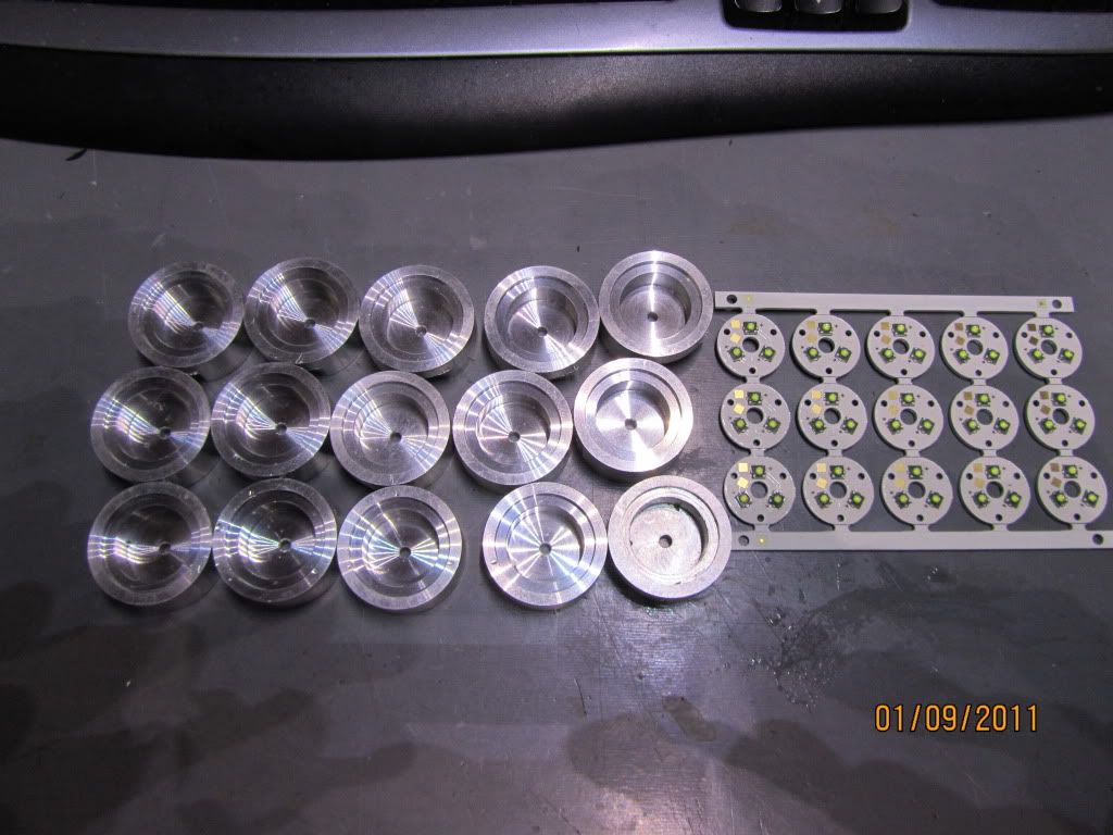

Is anybody making (or got stock of) 33mm OD heatsinks for Lumicycle cans???

A lot of people were using a modified nitro rc car flywheel. I can't remember the exact make (I think it might have been an HPI one).
I had the one above made for me, but I don't have any spare, unfortunately.
Main problem with a suitable heatsink is that it can't be too large as the cans are so small, which limits how much heat you can get to the outside, especially with the more powerful drivers. That is why I tried to add surface area in contact with the can via a thin sleeve that sits in the 'dead space' where the lens sits. I have no information to say how effective this method is, compared to just a metal disc.
However you do it, the heatsink needs to make good contact with the can. This is the main problem with my heatsink - I made it oversized & then sanded it down so it was a snug fit. The second one I did was a bit too snug & was impossible to remove without knackering the LED board. It was my fault for not sanding a bit more off it, than I did.
You could probably get a nearby machine shop to rattle you off a couple of 33mm alu discs (5-6mm thick) with 5mm holes in the middle for a few quid each and a packet of hob nobs....

When I converted mine a year ago, the flywheels seemed to be impossible to get hold of - sold out and discontinued.
I had some heatsinks made up, and the surplus ones were spoken for very quickly on this site. Trout's heatsinks weren't available then, so worth taking a look at those.
I'm looking to do a conversion on my last halogen, but like others have said the flywheel heatsink are impossible to get hold of.
I'm trying to get a few halogen heatsinks turned in the next week or so you I should have a few for you guys if that helps

I have these left over from last year if anyone wants to buy them as a job lot .
the leds are XPE`s so give a narrower beam over the XPGs
the optics are available from Farnells .
Heatsinks cost me £1 each
the led boards are just shy of £8 on cutters now though I paid more than that last year.
Job lot for £140 posted
Posted : 01/09/2011 5:36 am
