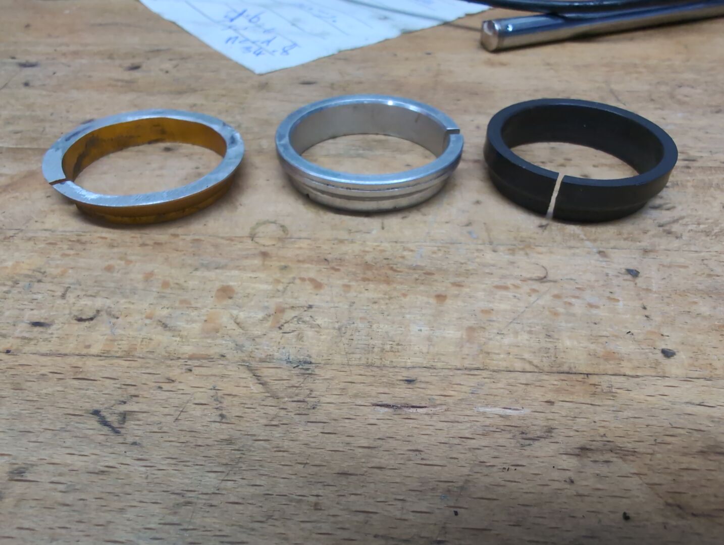

Posts: 211
If it doesn't work, give me a shout and you can try these...
Posted : 20/04/2026 8:48 pm
Posts: 211
  17767144568588958706148464253030.jpg Once more with feeling...
Posted : 20/04/2026 8:49 pm
Posts: 270
Unfortunately the one I ordered was too deep in the wider section, and so was too pronounced when fitted into the headset bearing. It was also rather tight and the steerer tube would not go through, although I imagine with some lubing that it would slide in just fine
Posted : 21/04/2026 3:49 pm
Posts: 211
If you wanna DM me yor address, I'll happily chuck those 3 in an envelope. If you want, you can send back any that don't work...
