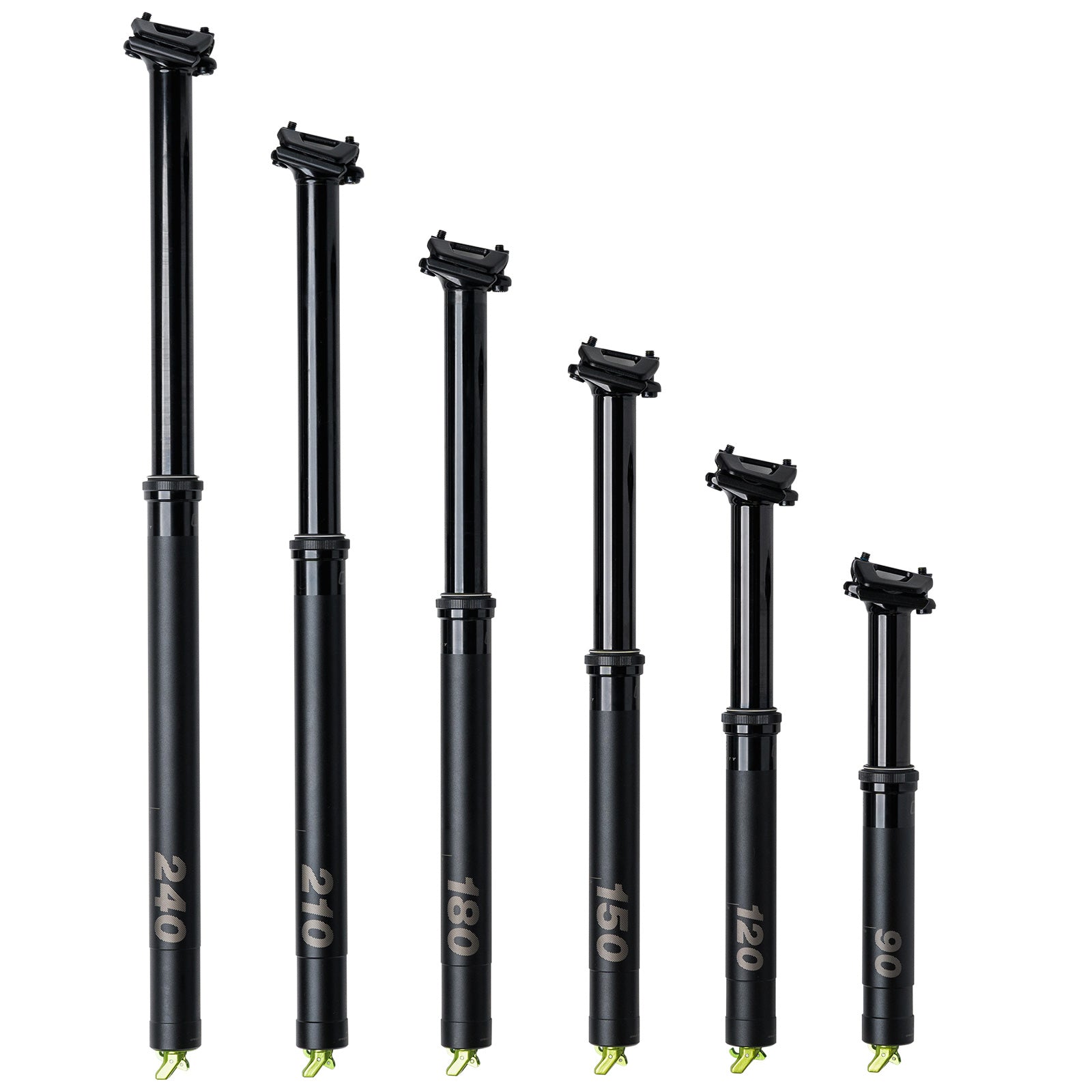

Posts: 3072
one up are good for the money circa £160-180
https://www.oneupcomponents.com/products/dropper-post-v2?variant=19543531094113
(31.6) 90mm 430g / 120mm 450g / 150mm 500g / 180mm 545g / 210mm 590g / 240mm 668g
versus Brand X Ascend
Weight: 535g (31.6mm/ 125mm), 605g (31.6mm/ 150mm)
reverb 120mm 31.6mm 592g.
*weights exclude cabling and lever

Hi , I realise this thread is 6 months old but I found it useful recently having just bought a Gen1 Supercaliber in the sales and needing a dropper for it without adding too much weight. Figured this might assist someone else…
Anyway. After reading and googling I bought a OneUp dropper in 30.9 dia and a USE shim (10g) to take it out to 31.6 seat tube dia.
The stock alloy post that came with the bike weighs 394g.  The OneUp dropper (in 90mm drop spec - can also be had in slightly heavier 120 or more) weighs 378g.  Yes I needed to add cable and lever but it’s still not much of a weight penalty.  A word of warning : the 90mm post is quite short, so if you’re long legged make sure the total length of the new post is enough once the minimum insertion length is taken account of.
<br />As the bike has a remote twin suspension lockout lever on the LHS of the bars (where a  front derailleur lever would be if it wasn’t 1x)  I needed a 2x compatible lever - PNW supply one and it’s a little thing that weighs not much at all.
Anyway, hope this helps someone else in the future. Thanks to all for the advice above.

For info… the 90mm One Up is now for sale (see classifieds!) It really was too short and I wish I had measured a bit more carefully/ tried to be less of a weight weenie.  Ive replaced with the 120 drop version which is only marginally heavier.  They get good reviews and hopefully it will be good for me.
