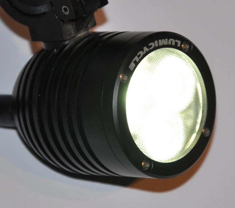

Hi all,
I am hoping to modify my Lumicycle Led3 bike light. It currently has 3 Cree XRE - R2 LED's and i have the following questions.
1) Can i retrofit XPG LED's to the existing MCPCB using the existing driver?
2) Can i retrofit the following http://www.cutter.com.au/proddetail.php?prod=cut936 with XPG's and install in the lamp with the existing driver?
I need more Lumens damn it 🙂
Thanks all in advance.

would have thought so yes, you may need new optics though
Posted : 15/10/2009 6:37 am
Never seen inside one but it may be possible if you have it in bits chuck up a few pics
but the XPG leds are daed small compared to the R2s
The linked to stuff should fit and be easier

I am going to ask cutters whether they can supply with the led's attached, they do some boards like that already. The optics look identical to the ones on my Lumicycle light so i wouldn't be surprised if they don't use the same board etc. Tried to open the light last night but its held together with silly small Torx bolts so need to get a new bit to undo them.
As i understand the output current from the existing driver will be at set levels suitable to the R2's so if the input current for the XP-G's matches i`m good to go. i.e if max mode on the light is at 1000mA and the XP-g's are rated to this i'll be ok. Am i right!?

I would get hold of a 2nd hand lumicycle halogen lamp casing or something similar, and buy a driver too. It'd cost you a few more quid, but then you're not risking screwing up the very expensive lumicycle light just for a little bit of extra light. It'll be dead fiddly soldering to get those LEDs in anyway, and it'd be an expensive mistake if you screwed up something inside the lumicycle.

shorts_in_winter - I'm about to do this too. I am just waiting delivery of the new XPGs on a PCB ordered from cutter. Also new optics to suit the XPGs are in the same order.
I actually rang Lumi and had a long chat with them on the phone. They weren't up for telling me how to dismantle it, and whilst I don't blame them, you'd think they just tell. They will offer a retro upgrade by the sounds of thing, just not yet.
Worth keeping this thread up to date with a how to guide.

OK, so I just braved the dismantling job, and I have to say thankyou Mr Lumicycle. It is a simple case of just pulling the PCB with the LEDs on out of the lamp body. It is just held in place by to push fit electrical contacts once the lens is removed. I used a pair of circlip pliers to grip the PCB via the holes that locate the lens.
I guess I have just rather publically voided my warranty, but judging by what I can see it is typical A1 build quality by Lumi so hopefully no worries on that score.

As my light is one of the first it doesn't have the push fit plug of the newer ones, just a couple of wires.
In the end the local (Australian) distributer for Lumicycle fitted the 4 XRE pcb for me, which has given a big boost to output. I may well still upgrade to XPG's later down the line but this will do for now.
How do the stock optics perfom Markyd? I have been told the lumi ones are bespoke, although they look a lot like the cutter ones.

[url= http://www.singletrackworld.com/forum/topic/diy-lumi-led3-upgraded-to-xpg-r5-leds ]LEDs arrived and it is all together and working. Here's a quick guide with pics. [/url]
