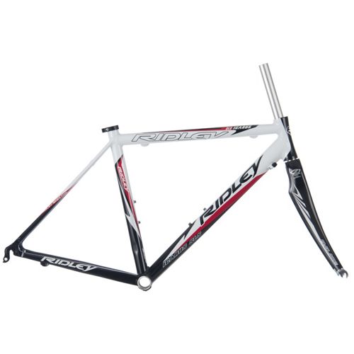

I've just almost finished assembling a Ridley SLS alloy frameset.
I went to fit the front mech only to find a largish dent where the mech should go.
The band of the mech wont fit as the dent's squashed it a bit.
The dent is smooth, no cracking or chipping. I reckon by fitting a longer bolt in the mech clamp I could re shape it, then fit the right bolt.
Do that or get a replacement.

My SLT has a dent in the same spot. It looks like its supposed to be there like a chainstay dent for clearance. But I'm not entirely sure. I'll take a pic tonight.
Posted : 21/11/2013 11:32 am
[url= http://media.chainreactioncycles.com//is/image/ChainReactionCycles/prod92907_IMGSET?wid=500&hei=500 ]is this it?[/url]
Looks like there's one on this pic too
Posted : 21/11/2013 12:53 pm
 tsd
@tmb467 thats what my 'dent' looks like.
Posted : 21/11/2013 1:36 pm
 Jase
Posts: 27
Carl I built up a bike with a new frame in the summer and it had a dent there so quite sure its meant to be there, not sure what its for though.
Posted : 21/11/2013 1:38 pm
Posts: 2746
It looks like where a direct mount front mech would sit only minus the screw hole/fix point. :-\
Posted : 21/11/2013 1:45 pm
It's for clearance for the mech cage - should mount mech above it
Posted : 21/11/2013 2:44 pm
Posts: 12148
Yep meant to be there. It was a bit squished though and I had to find a longer bolt as the mech wouldn't fit the tube correctly. Tightening up the mech re shaped the tube so I could fit the right bolt afterwards.
The 'dent' is for clearance.
