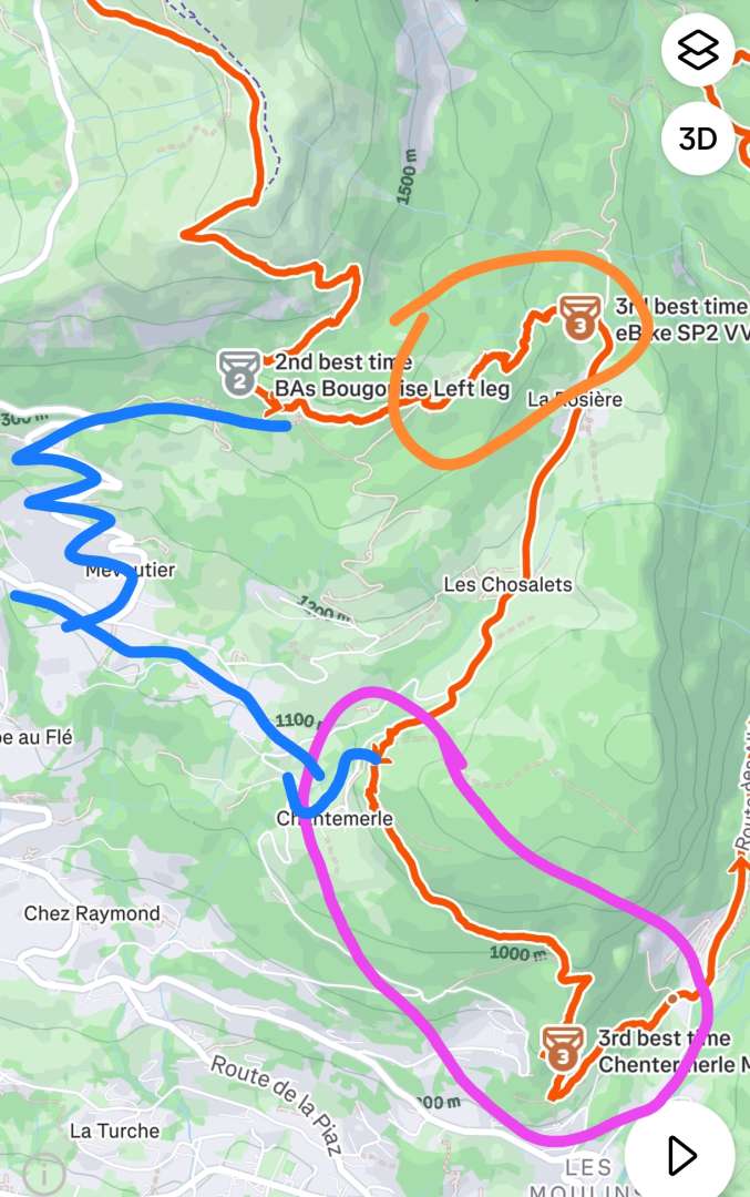

Posts: 1214
Purple = Best bit
Orange = Good bit
Blue = ways across from straight on La Bourgeoisie route instead of dropping straight to valley to make it a longer descent.
There are multiple options of the straight on La Bourgeoisie route was what I was trying to say. After the first road crossing if you turn right it's quite a different descent. The 'left turn near the top' is what I was referring to the Vers Samoens option.

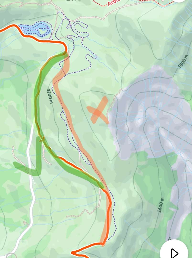

Posts: 1214
To get to the start most people prefer the more climb but rideable green route rather than the super bumpy orange route.
Posted : 28/05/2025 10:58 am
