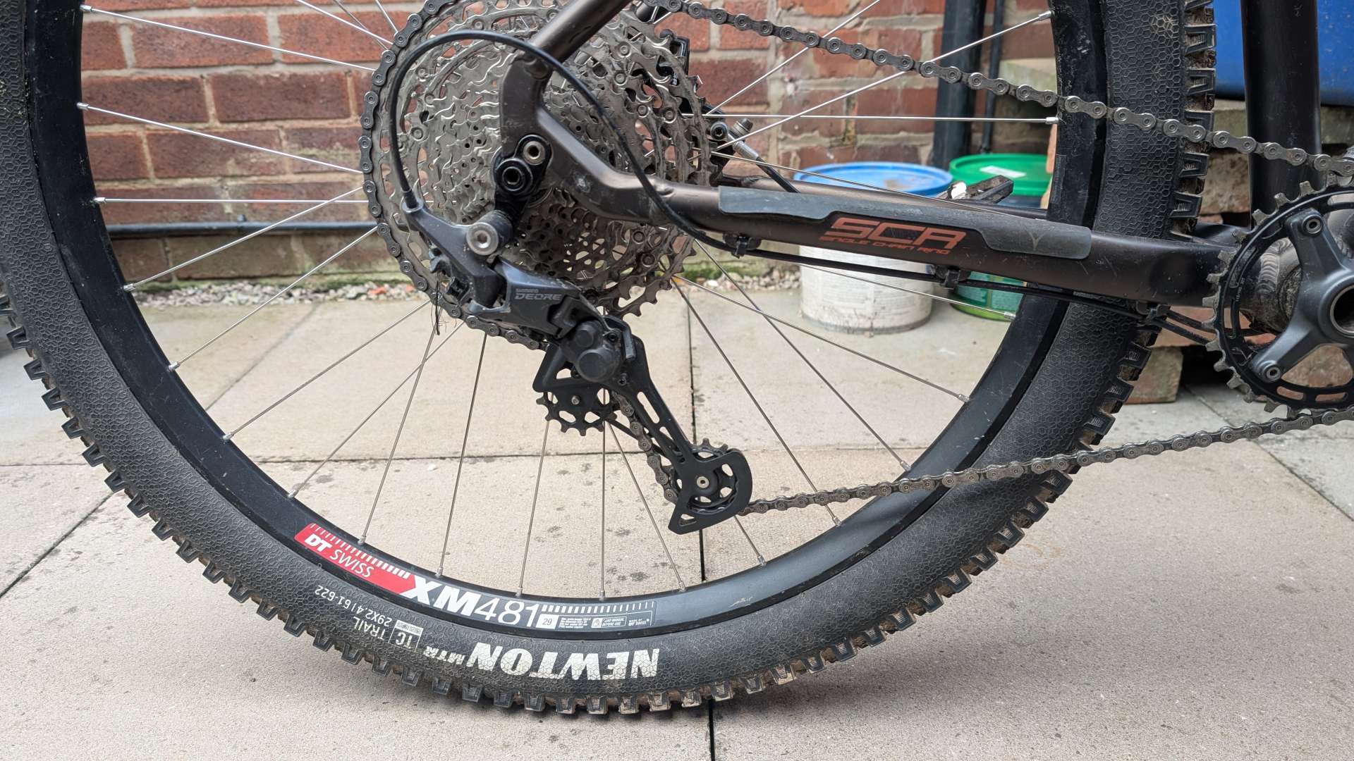

I went exactly by Shimano's instructions although I am using a 10-52 but I cut it as if it was a 51t if that makes any sense.
I don't mind cutting it again but will that resolve the problem of it dragging on the chain stay when no tension? Should that be like that?
Or is the solution somewhere else?
Indexing was very tricky. Is that because the chair length is wrong?
I am fairly confident that limit screws and b screws are well set up.
It's a 2020 Canyon Neuron and basically replaced the SRAM NX with Shimano 12s SLX cranks, Deore mech and shifter and GX cassette.
[url= https://i.ibb.co/wHsK9Kq/Screenshot-2025-04-26-17-54-38-841-com-miui-gallery-edit.jp g" target="_blank">https://i.ibb.co/wHsK9Kq/Screenshot-2025-04-26-17-54-38-841-com-miui-gallery-edit.jp g"/> [/img][/url]
[url= https://i.ibb.co/BHRcXv6w/Screenshot-2025-04-26-17-54-21-592-com-miui-gallery.jp g" target="_blank">https://i.ibb.co/BHRcXv6w/Screenshot-2025-04-26-17-54-21-592-com-miui-gallery.jp g"/> [/img][/url]

Just realised I posted the least relevant picture
This is the one:
[url= https://i.ibb.co/604Rs8MG/Screenshot-2025-04-26-17-54-21-592-com-miui-gallery.jp g" target="_blank">https://i.ibb.co/604Rs8MG/Screenshot-2025-04-26-17-54-21-592-com-miui-gallery.jp g"/> [/img][/url]

What's it like at the other end of the cassette? And what is the gap between the top jockey and largest sprocket like?
TBH it took me a little while to twig that modern Mechs are actually happier with more chain and using quite a bit of the range of "swing" on the cage.
The old trick of having a chain so short that the mech is stretched tight on the largest sprocket with the chain only one link away from snapping just doesn't work
So long at the chain isn't actually hanging slack in the smallest sprocket, you should be able to tweak the B-screw and get indexing to work (assuming your hanger is straight).
Posted : 26/04/2025 8:05 pm

At the other end:
[url= https://i.ibb.co/qFkpBWC2/Screenshot-2025-04-27-11-35-23-634-com-miui-gallery-edit.jp g" target="_blank">https://i.ibb.co/qFkpBWC2/Screenshot-2025-04-27-11-35-23-634-com-miui-gallery-edit.jp g"/> [/img][/url]
Agreed about chain ring but it's my partner's and she is used to that gearing. I can't remember if the chain was dragging before I swapped everything away from Dumb Dub.
Posted : 27/04/2025 11:41 am

How does the set up guide on the back of the mech look? Where is the B tension set? It looks like it needs less.
I'm suspicious of the mech hanger but any 2020 model bike should be Shimano 12 speed compatible.
Posted : 27/04/2025 11:58 am

That just looks like 1/2 a turn of b screw away from being ok.
Posted : 27/04/2025 1:25 pm

Thanks all  Out and away from the bike. Will B screw adjustment lift the chain away from the chain stay in the 10?
Posted : 27/04/2025 1:29 pm
 Yak
Posts: 6941
Yes, if the mech isn't fully compressed which it shouldn't be looking at the other end of the range photo.
Posted : 27/04/2025 1:43 pm
Posts: 21739
More B tension will add chain tension. However, view the setup guide from the rear. It may be that you need less B tension to get the marking to line up. That may need you to adjust the chain length.
I recently had a similar issue and found that the mech hanger caused the mech to swing too far back. Once that was corrected, the mech sat further forward and as a result, I needed a pair of links removing

Yes, do what onzadog said first. Don't add lots more b tension if it's more or less right or you are on too much already or the shifting in the higher gears will be poor.  Is if your chain length is right and there isn't sufficient b tension then add some. If the b tension is right or too much then the chain is too long.
Posted : 27/04/2025 1:51 pm

Useful to see a photo of the rear mech in lowest gear - if there's no tension in the jockey cage spring (fully folded back) and the chain is slapping the top of the chain stay then suggest the chain is too long. When in biggest sprocket, can you still push the jockey cage forward?
Posted : 27/04/2025 4:26 pm

Simple yes from me. Unless it's going to grow a lot under suspension movement, arm should be further forward than that. This is my (11 speed) Deore derailleur in 1st. PXL_20250427_182127924.MP.jpg

Update. 30t as per OE spec. A tweak of the B screw did resolve it and did create tension without cutting the chain. It now clears the stay quite nicely. But the window for good shifting is pretty small.
Shifting is OK but nothing to write home about. I imagine the combo of a new Shimano chain with a very slightly worn SRAM cassette (with a SRAM chain previously) is never going to be amazing but they might mesh a bit better with a few miles.
