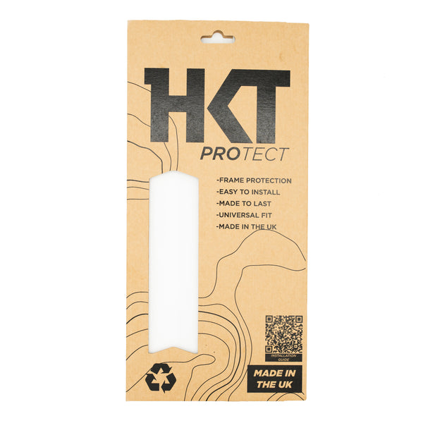

I butchered a set of these for the areas around the headtube on my frame which are prone to cable rub. Not fussed about resale etc as I tend to keep my bikes for at least 5-6 years, so resale value is not an issue.
https://www.hktproducts.co.uk/collections/bike-protection-kits
I also have some of these SRAM cable protectors to help mitigate the issue.
https://www.sjscycles.co.uk/cables/sram-outer-cable-protector-rubber-black-qty-4/
