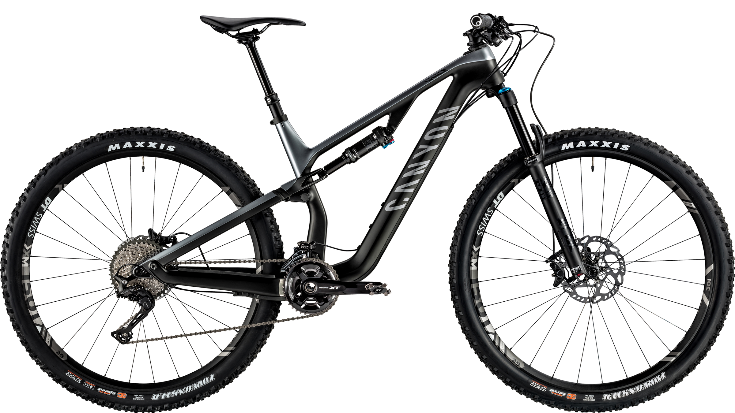

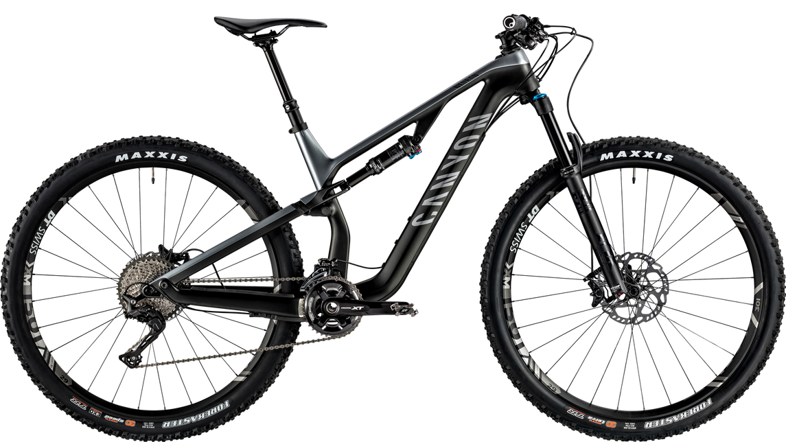

Posts: 7210
Canyon Neuron will fit your bill.
I have a the old version (Nerve) which is 110mm travel.
Neuron is still 2x / short travel 29er - I think they might have upped it to 120mm now though.
Posted : 04/04/2019 9:57 am
Posts: 58
Some of the Canyon neuron range are x2. 130mm travel but still X/C-trail.
https://www.canyon.com/en-gb/mountain-bikes/trail-bikes/neuron/neuron-cf-9.0/2069.html?dwvar_2069_pv_rahmenfarbe=BK%2FGY&dwvar_2069_pv_rahmengroesse=XS
Posted : 04/04/2019 9:58 am
