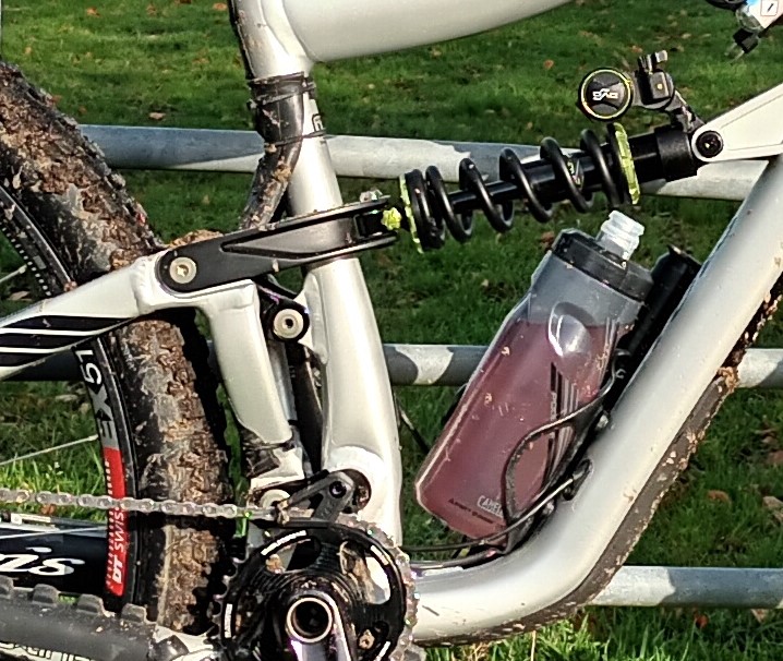

Posts: 3631
5'10ish here on an L, 210 OneUp v2. Fits beautifully! Now has a Cascade link which appears to have increased my grin size even more.

What does the Cascade link do?
Posted : 23/05/2024 3:08 pm
Posts: 8017
Just magic.
Ibis V2 Ripmo Link | US | Cascade Components
