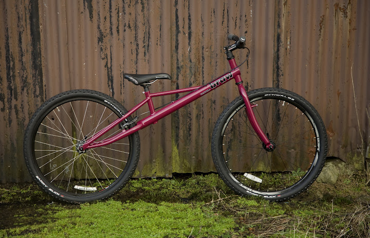

Posted : 19/01/2012 10:23 pm
Sorry, can't get photo to appear.
[img] ][/url] [/img]
