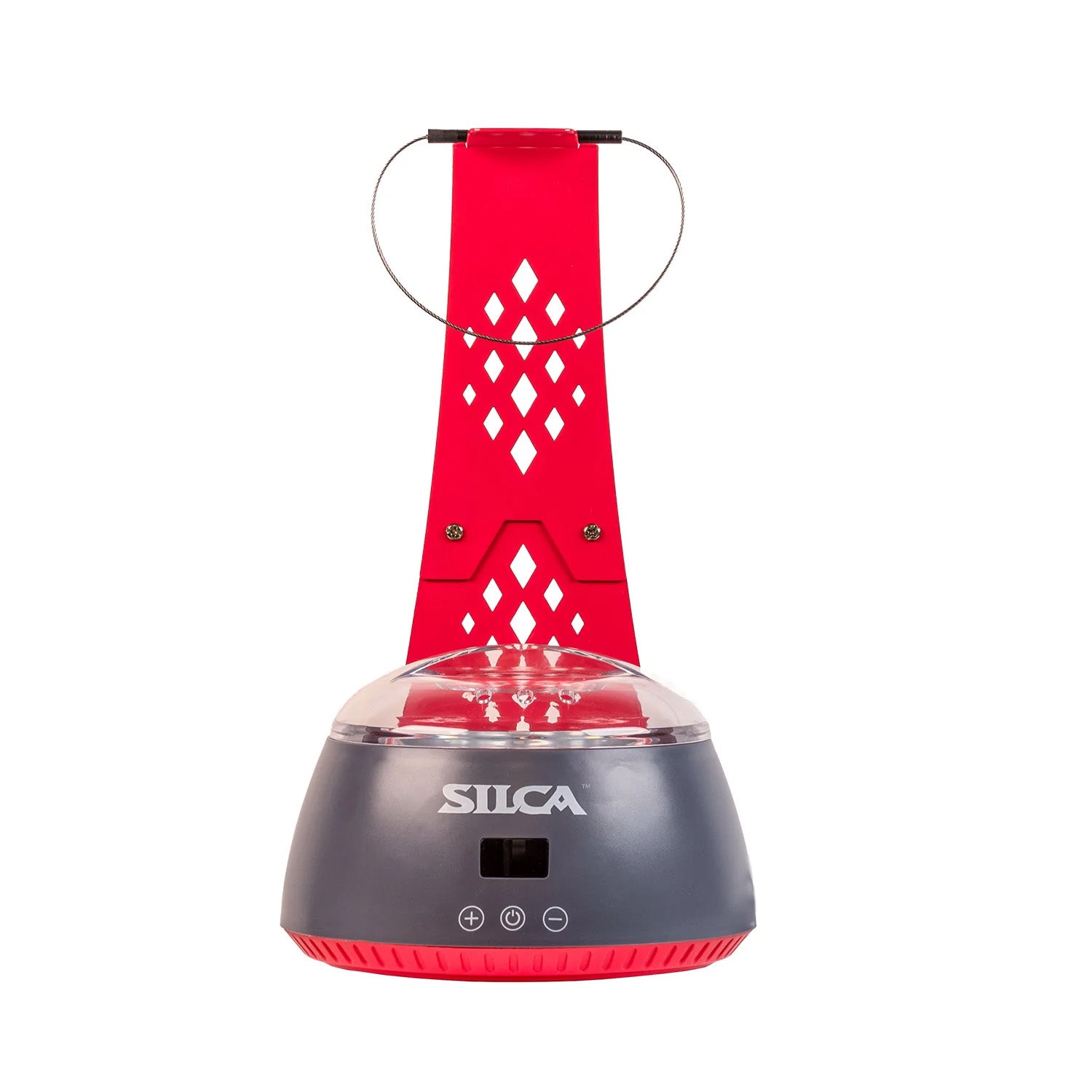

down another rabbit hole...and now I'm hot wax curious.   ZeroFrictionCycling seems to think Silca Hot Wax beats everything and I see they now have a complete system including a heater/hanger and even a magic 'chip' that means you can work from a factory greased chain.  And you can top it up with their drip on lube between wax dips.
Not cheap - https://saddleback.co.uk/products/silca-ultimate-chain-waxing-system?srsltid=AfmBOorpW1GH4ngGbrrBn8RGzfYwLbApSVg6StW0aQlcCyJNx5usW36m
but looks less effort that my current Smoove regime.
Am I right in thinking that these hot wax lubes are clean to the touch?  ie, handling changes is no worse than with smoove?  Other than cost are there any downsides? Has anyone gone back to regular lubes?

Yes, stuff like Molten Speed Wax and, presumably, Silca are clean and smooth to the touch, no oily, grimy marks etc.
The Silca system is ingenious, but really expensive as per all Silca things. The main pro is the chip thing, but if you look at Zero Friction doodah, they're now suggesting using Ceramicspeed's chain degreaser to clean factory lube off new chains, small amount of it sorts multuple chains, which offsets the stupid price. Then just use a cheapo 15-quid slow cooker and whatever wax you like the look of.
I've never used the Silca system, but it does feel like the main advantage is the Strip Chip convenience, but using the Ceramicspeed stuff is really quick and easy and a lot cheaper than the Silca system.
I wouldn't personally go back to conventional drip lubes, once you get beyond that weird cultish obsessive stuff that some chain-waxers seem to get sucked into, it's really clean and very simple. That said, I'm not sure it's optimal in a really wet, super gritty environment, like the Dark Peak over winter.

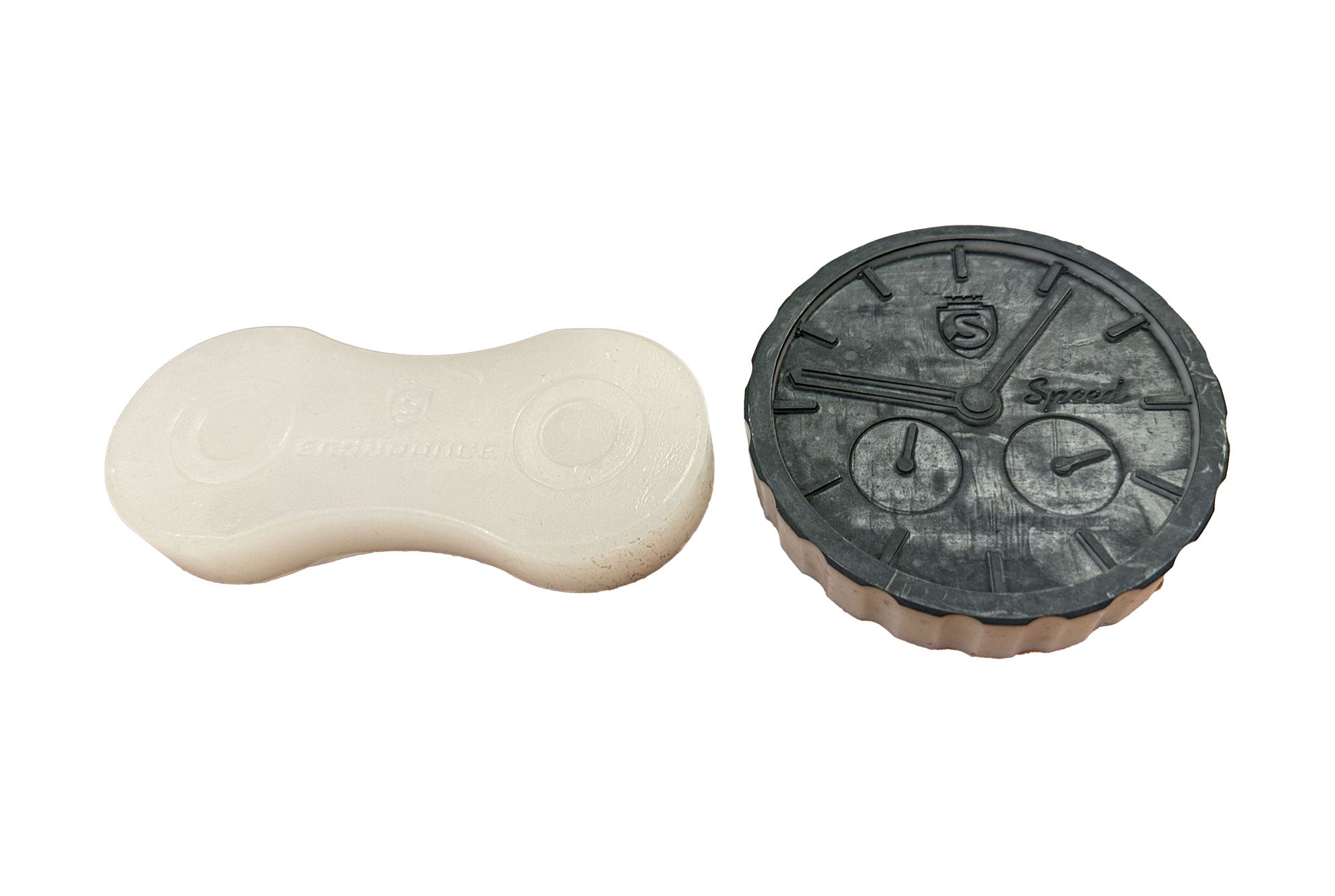

I'm on the GLF wax from Daz. It's extremely low effort, the only faff is waiting for the wax to melt and then removing before it gets too hot. It's not something to do just before a ride!
Posted : 12/08/2024 2:43 pm
Posts: 356
I use GLF Wax (half the price of Silca) and a beauty wax melter which has digital temp controls on it. The only time I'm not completely happy with using wax is during the depths of commuting; where rain and road salt can cause rust problems on the outside of the chain. I did experiment with putoline and while it worked; I find the more "just wax" variants much cleaner to work with !

I've just switched from putoline to a DIY wax.
Chain cleaning, yes it does seem to work better with a degreased chain. Give it a good wash in white spirit, then in degreaser, then in meths (or boiling water). It (IMO) doesn't need washing again, just drop it in the wax, sure some grit might get recycled back into the chain, but it's diluted into insignificance.  Probably worth cleaning if you've added wet lube though but I'm not sure either way (it's only something I've had to do so infrequently that I couldn't be conclusive about it.

This spring and summer I've been using paraffin wax bought off ebay applied using a small wax pot used for hair removal. Nitro cellulose thinners are great for removing the old lube from your chain, cassette and chainrings before wax application.
So far its been great. Lovely doing a bit of bike maintenance and not being instantly covered in black crap from the chain. I bought a second chain and am rotating them. So far I haven't had to clean a chain before re-applicaiton of wax but if you need to then heating it in boiling water will get the old wax and dirt off. Just make sure its properly dry before re-waxing.

My homebrew recipe is roughly 3 parts paraffin wax to 1 part bees wax, and a good dollop of grease. I tend to make up a new batch of wax every year.
It's really, really cheap after the initial outlay for whatever wax melting device you use ( I use a deep fat fryer)
I have 2 chains per bike and rotate them. Usually means I am re- waxing a few chains at once as a batch which cuts down time taken.
I strip the factory grease off the chain using white spirit. After that I never bother cleaning a chain I just dump it in the wax. All the crap falls to the bottom of the fryer. Whip the chain out, wait a few mins for the wax to solidify slightly then wipe the chain with a rag.

Posts: 2990
Ok.  First chains going into Silca wax.
What neither the Silca or ZFC instructions seem to cover is rewaxing them.
1) You've ridden the bike through a few filthy rides and it feels like it needs lubing - how do you prepare it before dipping it in your currently lovely clean wax?
2) how do you determine when your wax is 'done'?  presumably the level drops as you wax some chains and you keep topping it up, but you're also getting it dirty when rewaxing.  At what point do you scrape it all out and start afresh?
