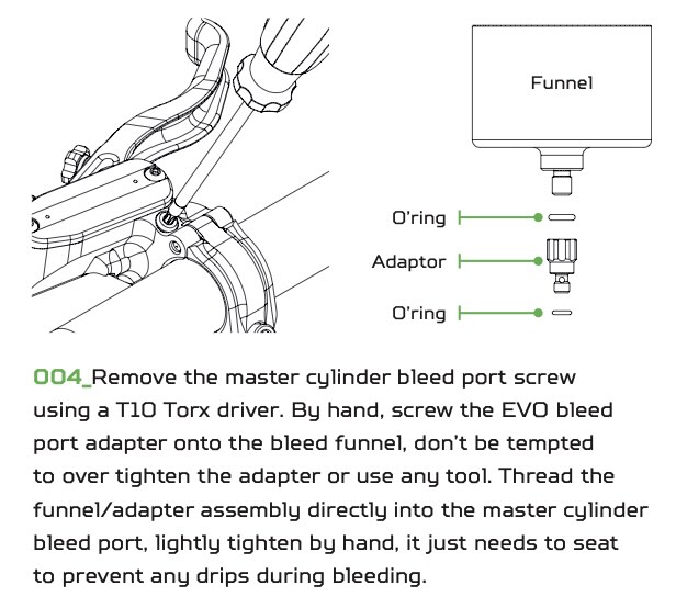

Having got onboard the reduced TR4s (thanks for the PSA), I was looking for a funnel to attach to the new bleed port.
I've found this from total bleed solutions which attaches to their aluminium funnel. And whilst I'm sure it's a nice bit of kit it also seems like (expensive) overkill when a plastic funnel does exactly the same job - Anyone found one which fits?

The Shimano plastic one is much the same price.

The Hope funnel doesn't fit?
Costs more than the TBS funnel. Still needs an adaptor as well. Unless there's a new one?
OP... that adaptor (or the cheaper Hope one - HBSP461) will also fit plastic funnels, such as the Shimano one I think, but it won't save you much... might as well buy a nice aluminium one. Oh, TBS funnels (you'd need cup+plug) are cheaper on eBay, which is how I bought mine. Compare prices with their website.
EDIT: Hope instructions show adaptor is used with their/any funnel...
