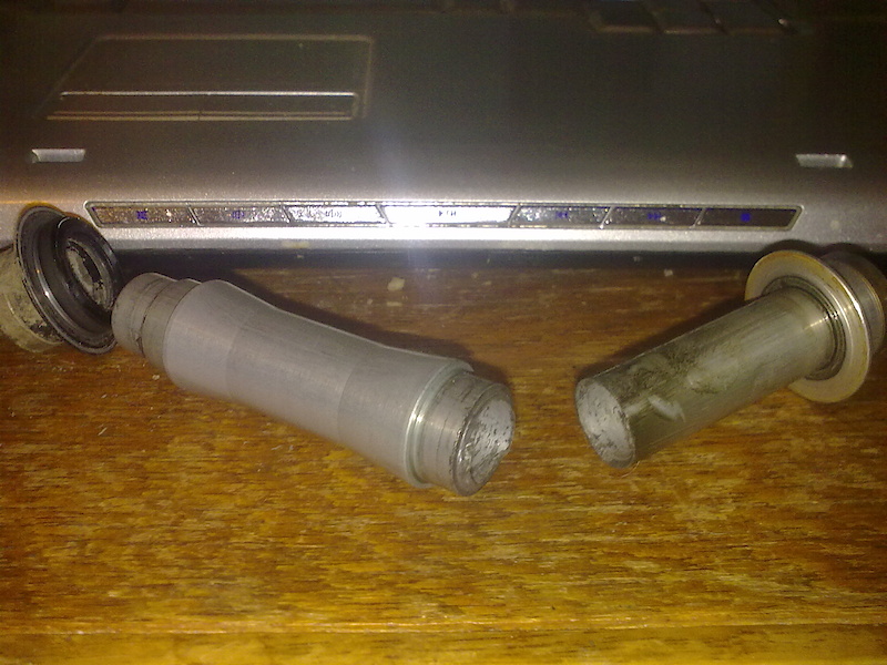

All they did to convert the pro 2 to take 12mm was drill a bigger hole through the axle- there's no meat left in it at all. Add to that a wee stress riser beside the middle bearing, right at the thinnest point. And this happens:
I've had 2 replaced on warranty- Hope know it's an issue and are very quick to deal with it when they go, so it's not too bad.
