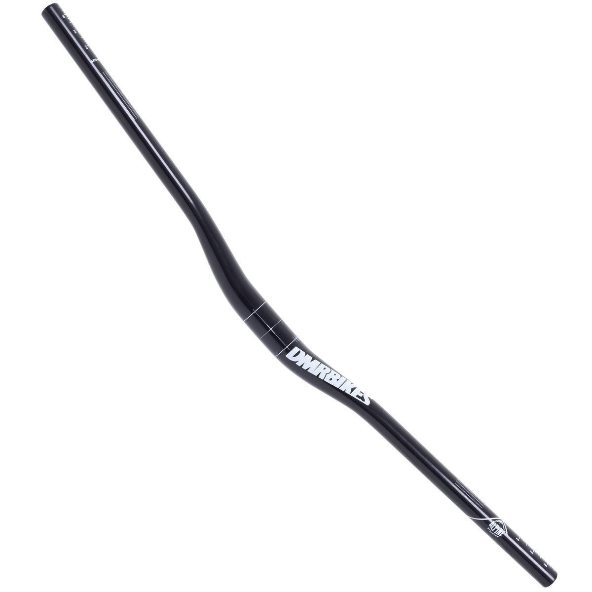

@sharkattack I've got some DMR Wingbars you can try in a 35 rise with 31.8
https://www.dmrbikes.com/Catalogue/Components/Handlebars/Alloy-WingBar-MK4
Used once.
Posted : 15/09/2023 10:10 am
