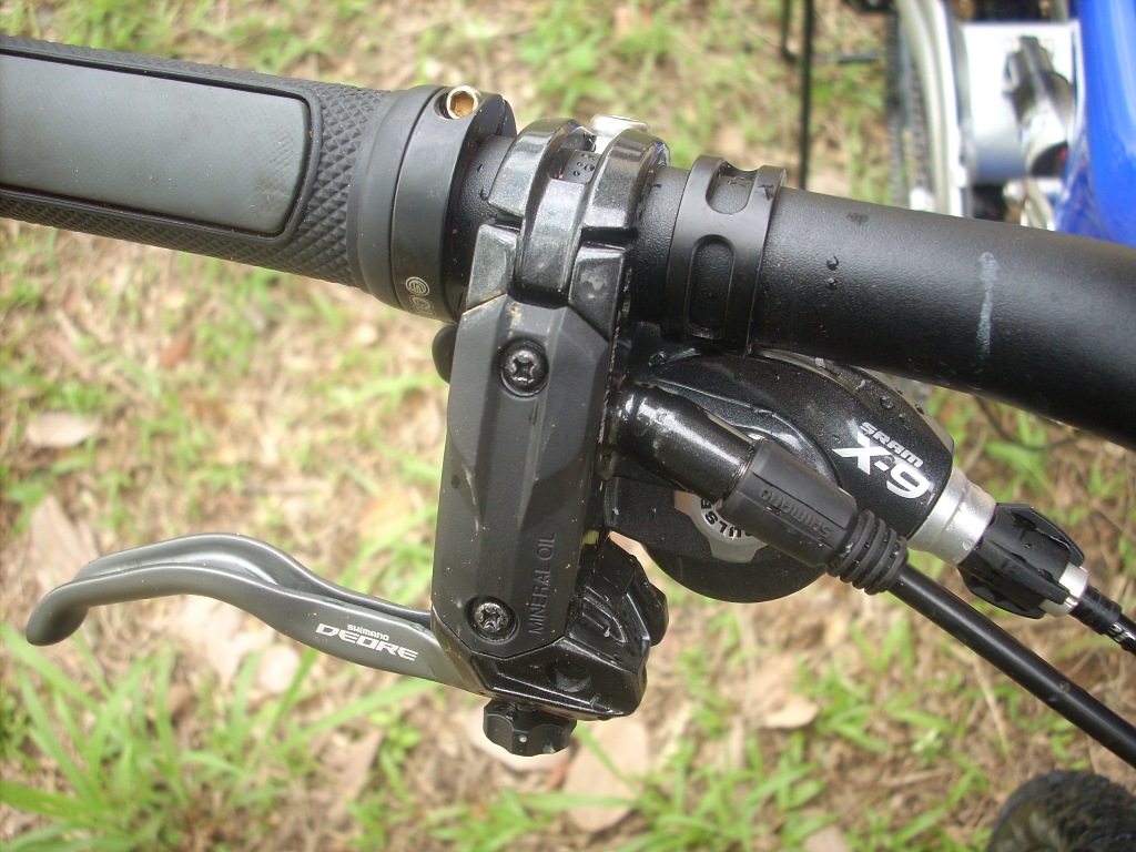

if you look at that picture you see the pastic bit where the hose goes into the lever, that is a cosmetic shroud and can be pulled back. Pull it back and underneath is a set of spanner flats so you can uncrew the hose from the brake lever. I suppose if your going to do it the "right way" you should replace the olive, in practice should be ok.
