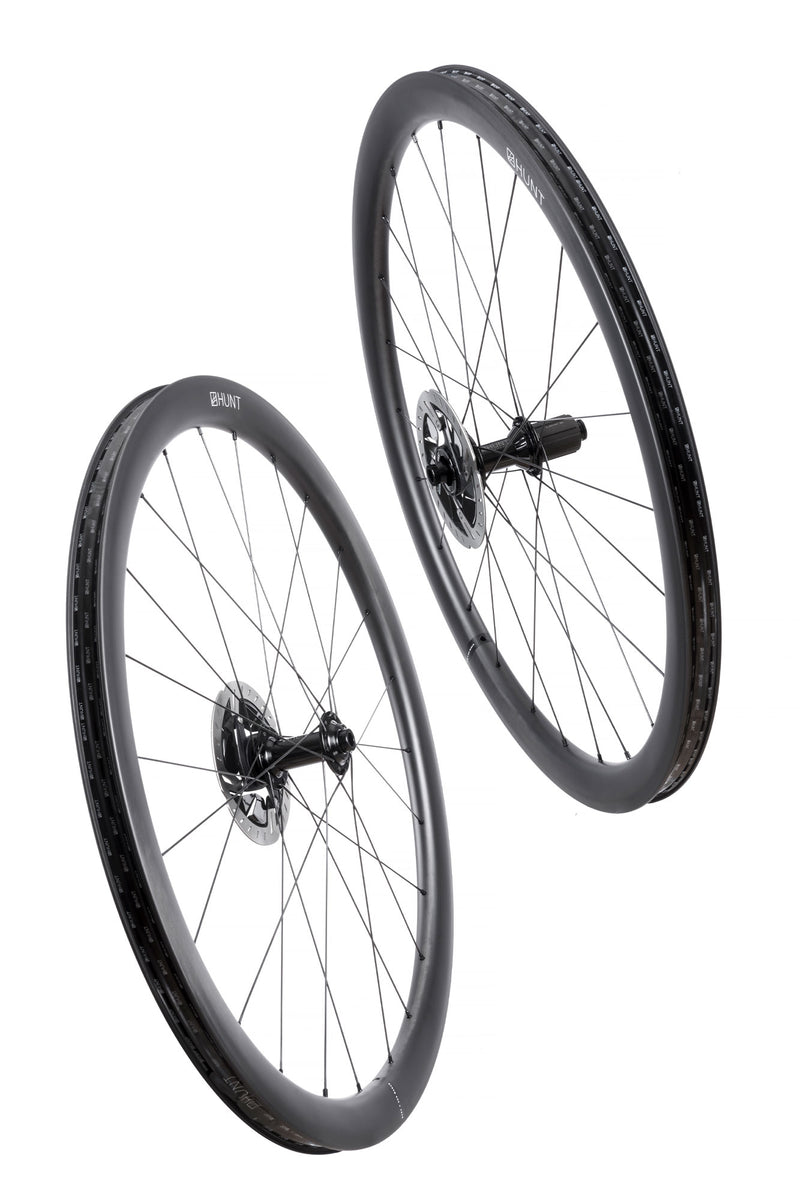

When I bought a wheelset a few years back it was hard to beat Hunt for price vs weight. I ended up with 4seasons road wheels which are meant to be 1550g (that was the v1). Hubs are still running smooth since I got them in 2018. Feel fast and look decent.
These are probably the current version
https://www.huntbikewheels.com/products/4-season-pro-disc-wheelset
If you could go up to just over £600 you could get some carbon ones - the 40mm deep ones are probably a good allrounder:
https://www.huntbikewheels.com/products/hunt-40-carbon-disc-wheelset

Taking your guts advice to look at Hunt - would these be a reasonable bet & work with my Diverge set up?
https://www.huntbikewheels.com/products/4-season-pro-disc-wheelset?variant=21358692597837

Sorry Joebristol - I didn't spot your links before replying... Thanks for the recommendations.
Definitely tempted by the carbon(!) but not sure I can justify... Would either work with my set up? (Sorry for being a bit clueless?)

Posts: 9440
Sticking with Hunt, I've got these on my Cervelo Caledonia with some 35mm tyres and noticed a massive difference over the stock wheels it came with. Alloy but still not a bad weight and the aero seems to make a difference.
https://www.huntbikewheels.com/products/hunt-34-aero-wide-disc-wheelset

I run the Hunt Carbon 40 with GP5000s tubeless referenced above on my gravel bike and can keep up with my roady mate on the flat. Hills are a different matter unrelated to kit.... I have 2x 11spd GRX but don't seem to miss the extra teeth on the big ring.
Makes a significant difference to how the bike feels on the road compared to the OE Giant CRX2 carbon gravel wheelset, mostly due to the tyres.
That combo is a bit above your budget though. If money is tight I'd grasp the nettle and swap tyres first to see if you get the gains you want. Unlike others on here, I've had no issues with the GP5000 tubeless set up, I run them at 60psi front and 65 rear. Punctures do happen but so far the worst have been fixed with a bung.
