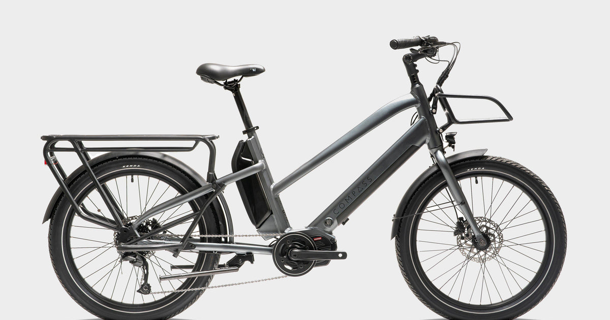

I know there's a fan base of e-cargo bikes on here, and this long tail just popped into my adverts, looks like a typical Go Outdoors bargain. £1800.
Possible weak link is the unknown brand, presumably Chinese mid-drive motor, but I imagine Go Outdoors are pretty strong on the warranty service.

I could be described as e cargo bike curious but I am too tall for this one and also would need more info on the battery capacity and power output/torque etc as I live up a steep hill

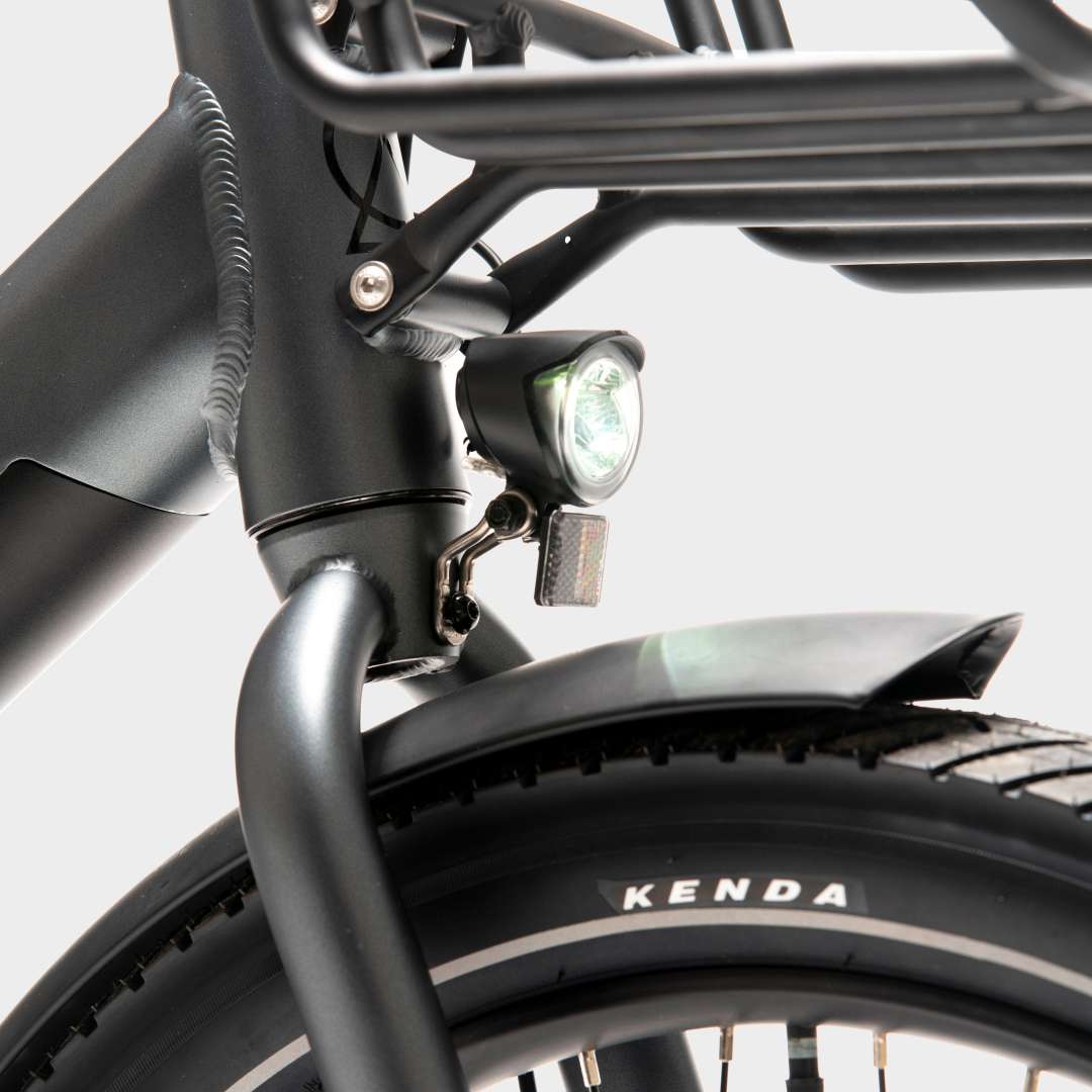

Not sure about the quality of the welding!
Posted : 09/02/2026 10:15 am
Posts: 3191
Strong not pretty?

Seems very light on detail for something you might want to drop best part of £2k on. Lack of detail is pretty common for go outdoors and if it's something like a pair of trainers or a tent and you can Google the details from a 'better' retailer....but on a £2k bike....

Looks like it's this, rebranded?
https://reidbikes.com/products/kade-cargo-ebike-dark-grey
Posted : 09/02/2026 12:25 pm
Posts: 20453
Looks like it. If it is, lowest gear is 38/32, which ain't that low although I guess it's fairly simple to stick a bigger cassette on.
Posted : 09/02/2026 12:37 pm
Posts: 12567
Yeah, I reckon that's the same bike.
Think I'd be looking upgrade the brakes at the same time as the gear ratios - 160mm rotors for a system weight of 200kg?! Sketchy.
Posted : 09/02/2026 1:25 pm
Posts: 20453
Yeah, I thought that too, but the brakes themselves are fine so a set of 180mm (or bigger on the front if you want) rotors + adaptors and you're sorted.
