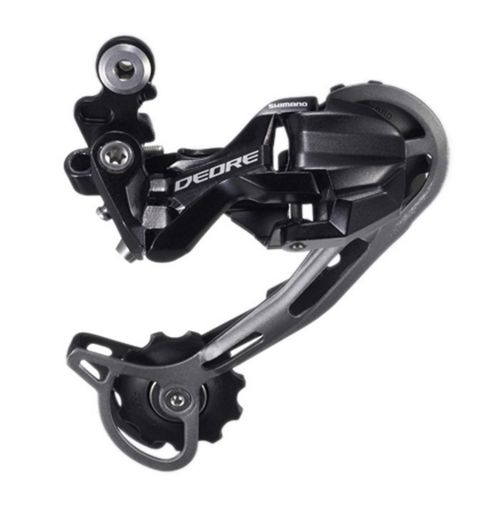

Posted : 15/01/2017 12:53 pm
Posts: 507
9sp mech will have the cable entry close to the mech body, 10sp is out on an extended arm, probably about 15-20mm away from the main body.
Posted : 15/01/2017 1:40 pm
Posts: 8960
The model number will be stamped on the back of the mech.
Posted : 15/01/2017 1:48 pm
Posts: 104
Thanks.
I'll check the number, but I think it's this one
http://chainreactioncycles.scene7.com/is/image/ChainReactionCycles/prod40542_IMGSET?wid=500&hei=505
Posted : 15/01/2017 3:09 pm
